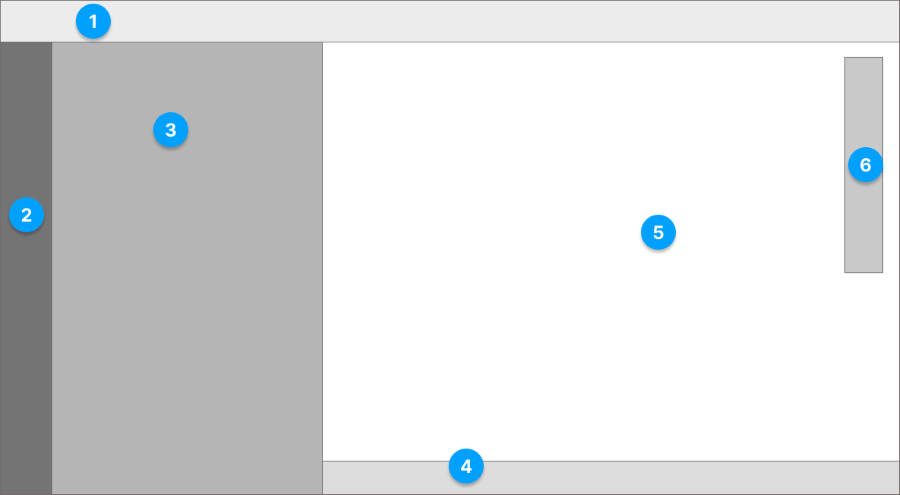

Creating or opening a Knowledge Studio project opens the main workspace. From here, you can explore the knowledge graph; create maps, link charts, and data cards; search the project; query the data in the knowledge graph; and configure a project dashboard. There are six key areas in the main workspace, which are shown in the following image and described in the table below. The numbers in the image correspond to the descriptions below.
Workspace diagram
Element Description
Element 1 Title bar The title bar displays the title of the project and provides access to Global Search and Documentation .
Element 2 Main menu The main menu allows you to navigate the project. It includes the following buttons:
  • Knowledge Graph—A quick link to the Knowledge Graph view.
  • Query—A quick link to the Query view.
  • Dashboard—A quick link to the Dashboard view.
  • Project Contents Project Contents—A list of all the content items in the project.
  • View Contents View Contents—A list of the contents of the current view, such as the layers in a map.
  • Save Save—Save the project.
  • Element 3 Pane list This area displays panes opened using the main menu buttons. It includes the Project Contents pane and the View Contents pane. The View Contents pane updates based on the type of content item that is open.
    Element 4 Content list Each open content item appears as a tab in this area. The number of tabs you can have open depends on the number of maps or link charts in each content item. If you reach the tab limit, you need to close a tab before you can open a new content item.
    Element 5 Main view The main view of the active content item.
    Element 6 Context toolbar The context toolbar includes tools for the active content item.
