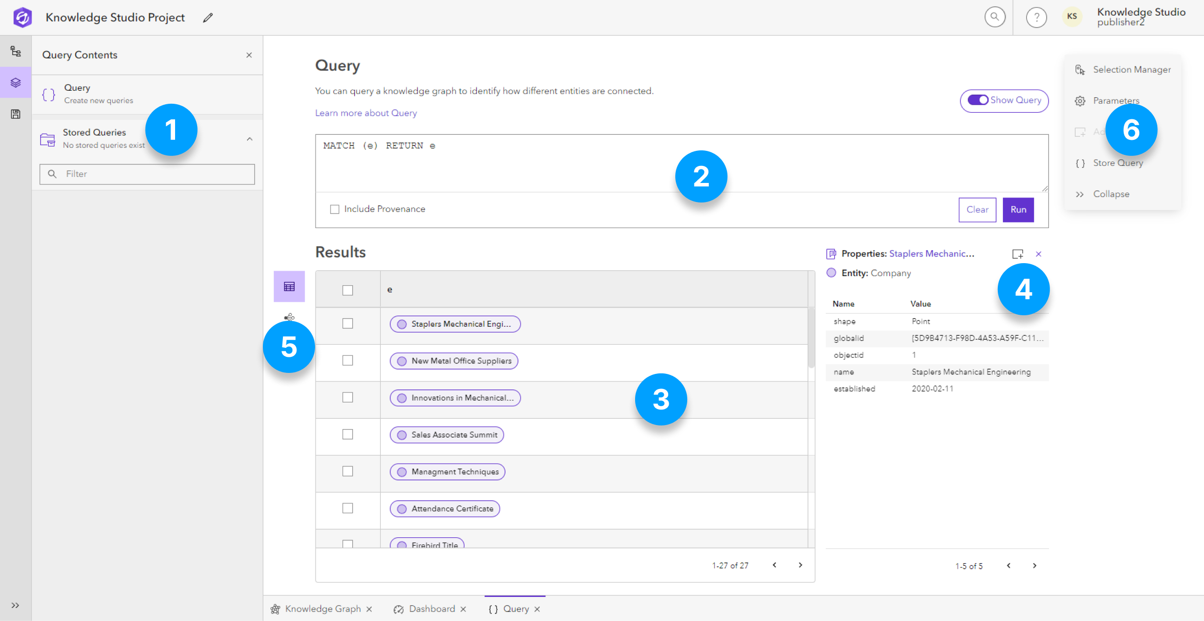

The Query view Query view is a default view in every Knowledge Studio project that allows you to query the contents of the project's knowledge graph. There are six key areas in the query view, which are shown in the following image and described in the table below. The numbers in the image correspond to the descriptions.
Diagram of the main areas of the query view.
Element Description
Element 1 Query contents The Query Contents contains the Query editor Query view where you write new queries and the Stored Queries collection Stored queries collection that are retained in the project when the project is saved.
Element 2 Query box The query box is a multiline text box that allows you to format and run your openCypher query.
Element 3 Query results The query Results are displayed in a table by default.
Element 4 Query selection Selecting a record in the Query Results allows you to explore the properties of returned graph records.
Element 5 Results preview You can preview the results and your selections in a link chart, map, or chart preview and add or remove all results from your selection using the results toolbar.
Element 6 Context toolbar The context toolbar provides tools specific to query, such as defining query parameters and storing your query in your project for later use.

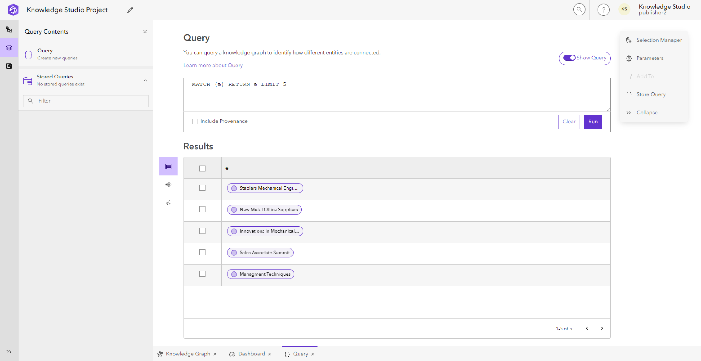

    If you don't know how many results will be returned from a query, add LIMIT 1000 to the end of your query to avoid unexpectedly returning tens of thousands of records, which may timeout your browser.

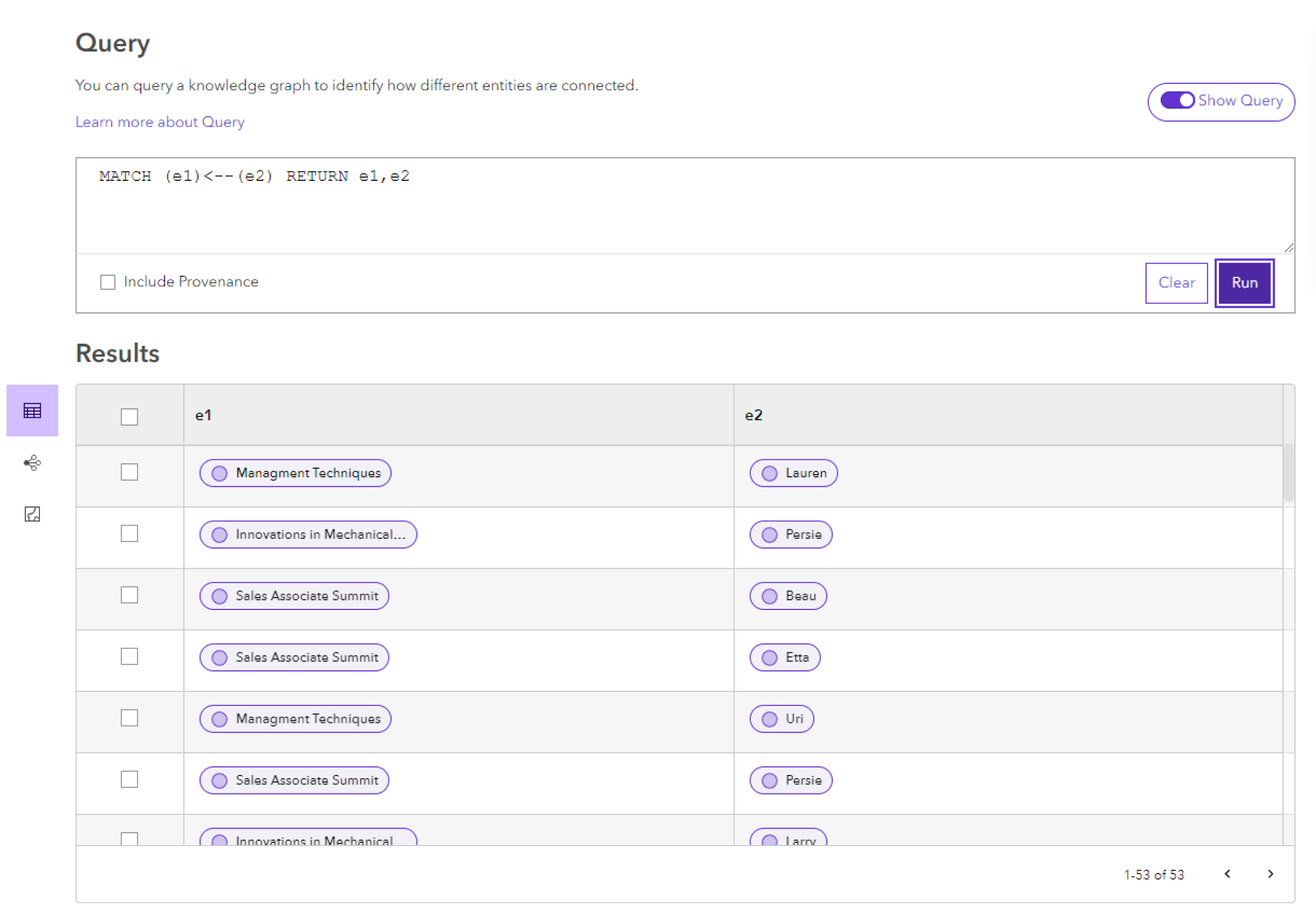

The query can identify entities that are related using symbols that create an arrow. For example, the query MATCH (e1)-->(e2) RETURN e1,e2 will return pairs of entities, e1 and e2, where any type of relationship exists between the two entities and any path from entity e1 to entity e2 connects the entities. If the query was written with the arrow pointing in the other direction, paths would be considered starting from the origin entity e2, to the destination entity e1: MATCH (e1)<--(e2) RETURN e1,e2. The manner in which entities are related to each other is referred to as a pattern.
Related entities returned by the query appear in the results table.

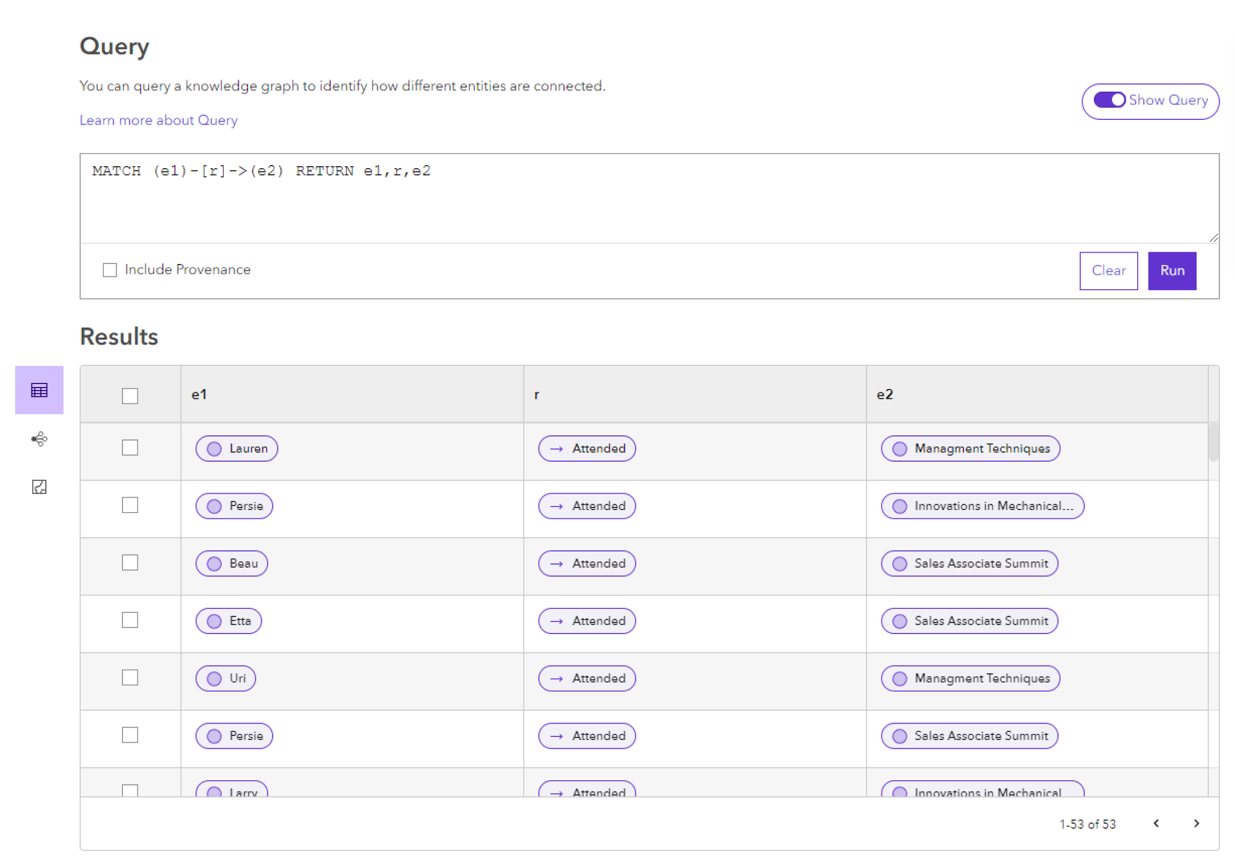

The query can identify specific relationships that should be considered in square brackets. For example, the query MATCH (e1)-[]->(e2) RETURN e1,e2 will return pairs of entities, e1 and e2, where a single relationship of any type connects the two entities. This query shows another way to represent the same queries illustrated above, and illustrates the preferred query syntax. The query can be amended to return the entire tuple describing the relationship by returning the origin entity, e1, the relationship, r, and the destination entity, e2, as follows: MATCH (e1)-[r]->(e2) RETURN e1,r,e2. Similar queries MATCH (e1)-[ ]->( )-[ ]->(e2) RETURN e1,e2 or MATCH (e1)-[*2]->(e2) RETURN e1,e2 will return pairs of entities that are connected by two relationships in the same direction. Queries can also identify patterns where relationships have different directions such as MATCH (e1)-[ ]->(e2)<-[ ]-(e3) RETURN e1,e2,e3.
Related entities and the entities that connect them are returned.

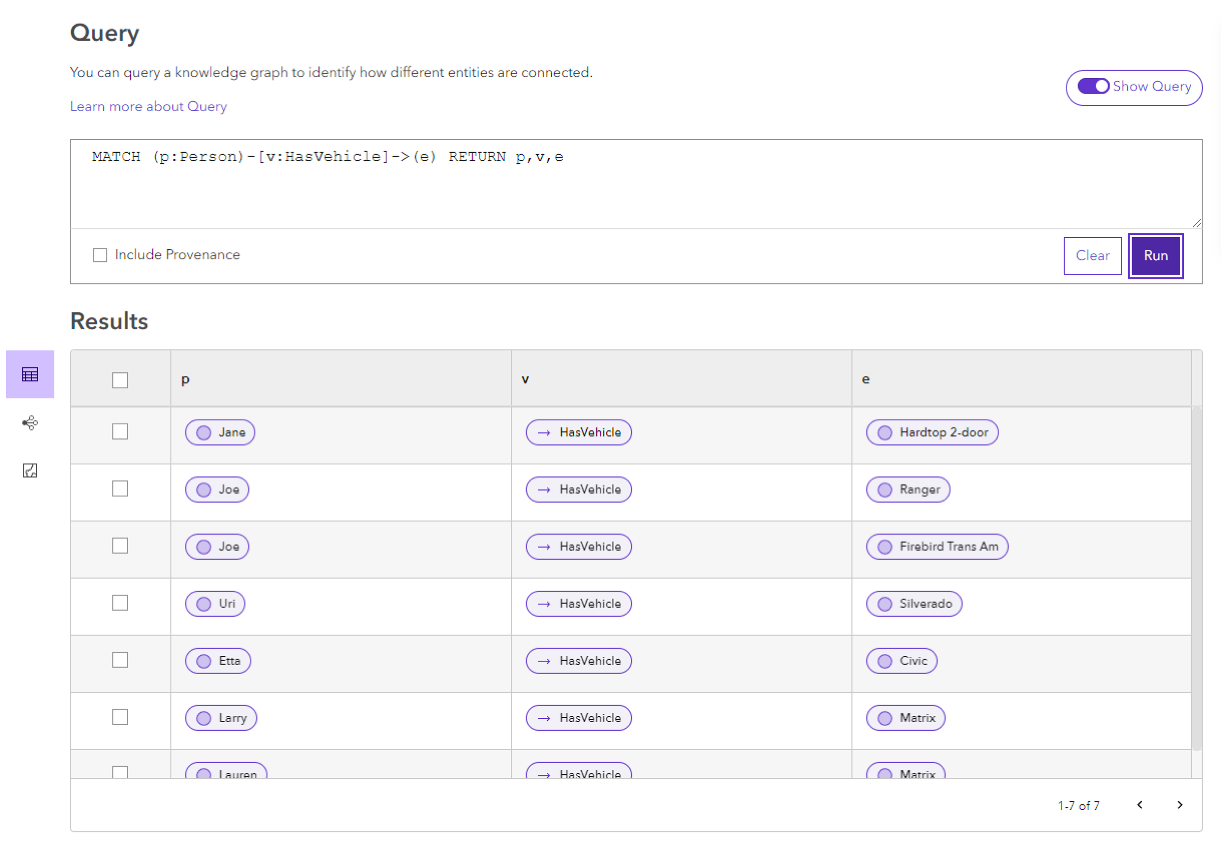

You can constrain the query to consider specific relationship types and specific related entities by adding relationship types and entity types to the other facets of the query. For example, MATCH (p:Person)-[v:HasVehicle]->(e) RETURN p,v,e will return all Person entities, p, in which a HasVehicle relationship, v, connects the Person to another entity of any type, e. The variables p and v are assigned to the Person entities and HasVehicle relationships, respectively, so information about them can be returned by the query. Compared to the previous example, relationships in which a Pet or Document entity are the destination of a relationship aren't included in the results. Depending on the knowledge graph's data model, the destination entity, e, could be a generic Vehicle entity, or it could be one of a series of specific entity types such as Automobile, Motorcycle, Boat, Airplane, Commercial Vehicle, and so on.

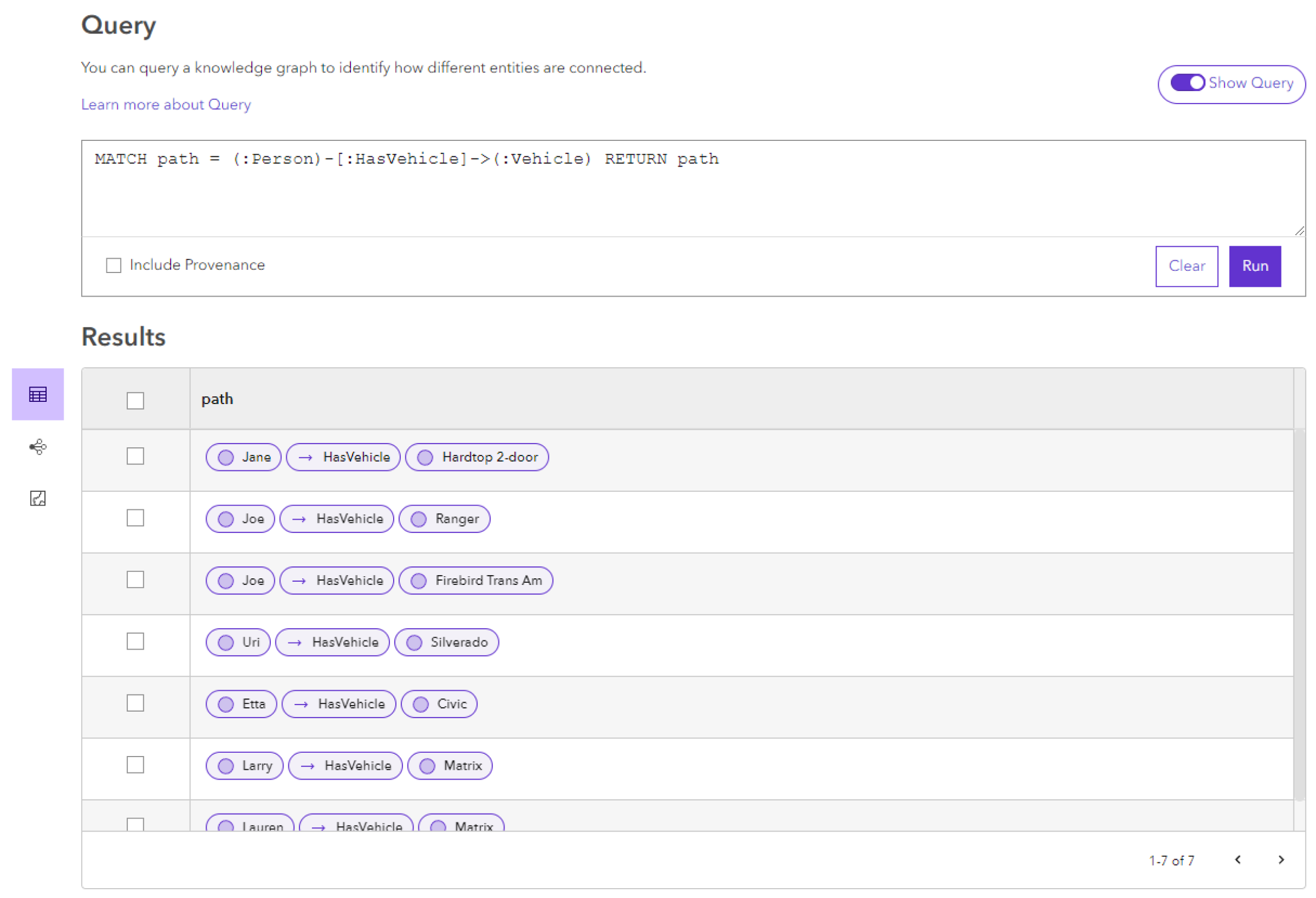

Instead of returning a series of individual entities and relationships, your query can return the complete path represented by a pattern. To do this, assign the pattern defined in the MATCH statement to a variable and return that variable. For example, the query MATCH path = (:Person)-[:HasVehicle]->(:Vehicle) RETURN path will return a list of paths for all entity and relationship combinations that satisfy the specified pattern. Each path will contain all parts of the matched pattern: the Person, HasVehicle relationship, and Vehicle. You do not need to assign variables to the individual parts of this pattern since they are not returned by the query.
Paths contain all parts of the match pattern.

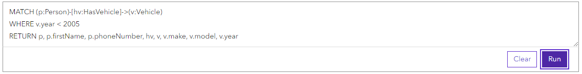

    For example, change the query to MATCH (p:Person)-[hv:HasVehicle]->(v:Vehicle) WHERE v.year < 2005 RETURN p, p.firstName, p.phoneNumber, hv, v, v.make, v.model, v.year to return all the Person entities that have the HasVehicle relationship to a Vehicle entity in which the year property of the Vehicle is earlier than 2005. The results will include values from the Person entity's firstName and phoneNumber properties, the HasVehicle relationship, and the Vehicle entity's make, model, and year properties.
    Press Enter to move the pointer or some of the query's text to a new line in the multiline text box. Use as many lines as needed for clarity.
    A query can span several lines when using the multiline query text box.
  3. Click Run to get new results.
