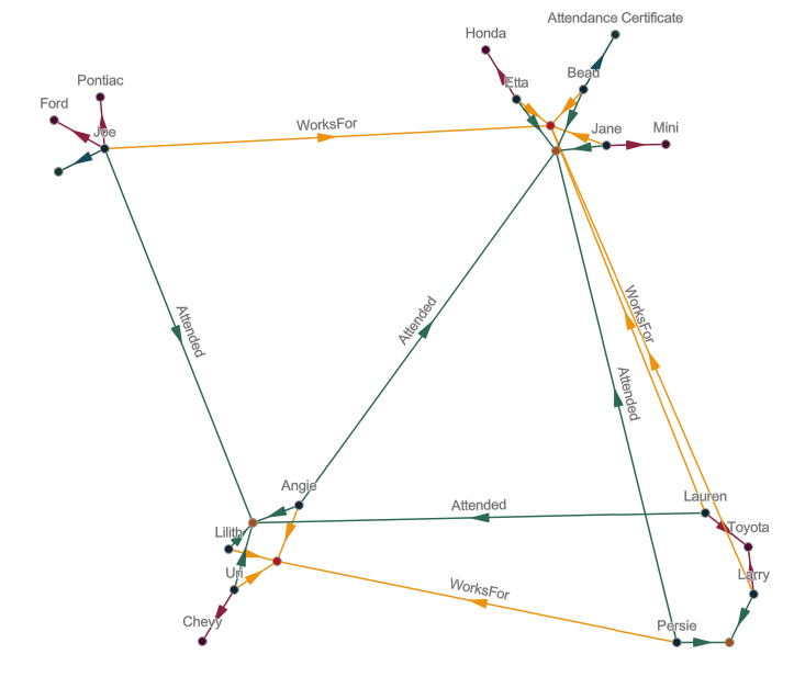

Organic layouts
In this group, entities are arranged on the link chart using force-directed layouts. This type of layout algorithm considers the link chart as if it were a mechanical system. The entities repel each other like two magnets aligned with the same poles facing each other, while they are attracted to each other by the relationships that join entities together. The algorithm iteratively reviews and places entities and evaluates the forces until equilibrium is reached. Settings allow you to customize how entities are placed. These layouts allow you to visualize entities in clusters that emphasize how they are connected.
The supported organic layouts are Force Directed, Community, and Geographic.

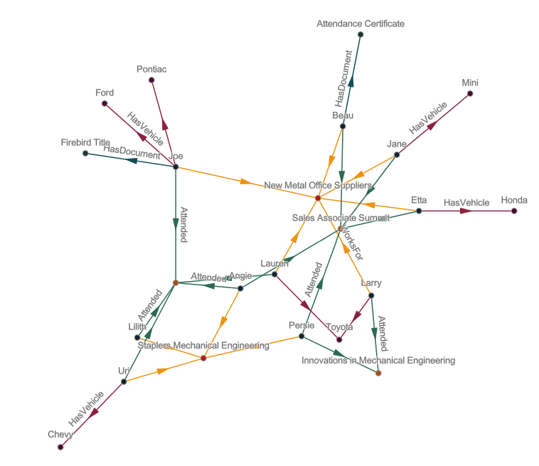

Force Directed
The Force Directed layout Force Directed layout considers the link chart as if it were a mechanical system. The entities repel each other like two magnets aligned with the same poles facing each other, while they are attracted to each other by the relationships that join entities together. The algorithm iteratively reviews and places entities and evaluates the forces until equilibrium is reached. This layout allows you to visualize entities in clusters that emphasize how they are connected.
The Force Directed layout is the default layout used to arrange entities and relationships when a link chart is created.
Force Directed layout diagram

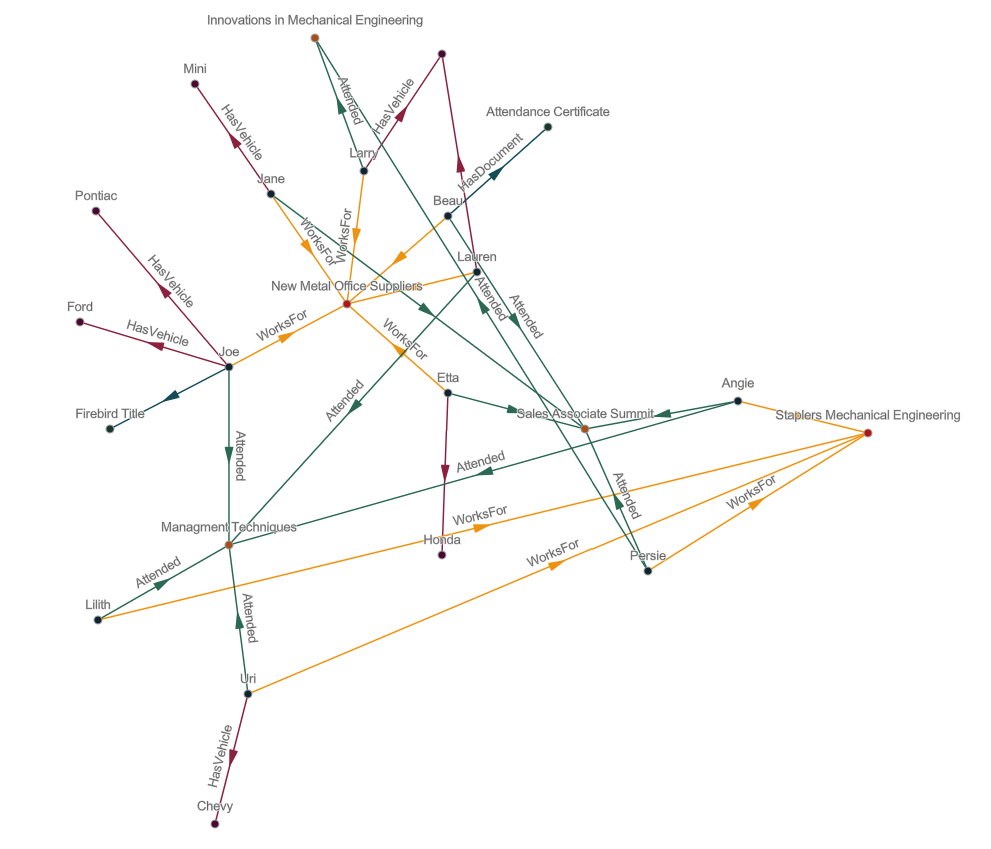

The Community layout Community layout finds communities, which are groups of entities that are closely related to each other. The Force Directed layout is then used to arrange the communities. The attraction forces along relationships between entities of different communities are relaxed so that different communities are more spread out than with the standard Simple layout.
Community layout diagram

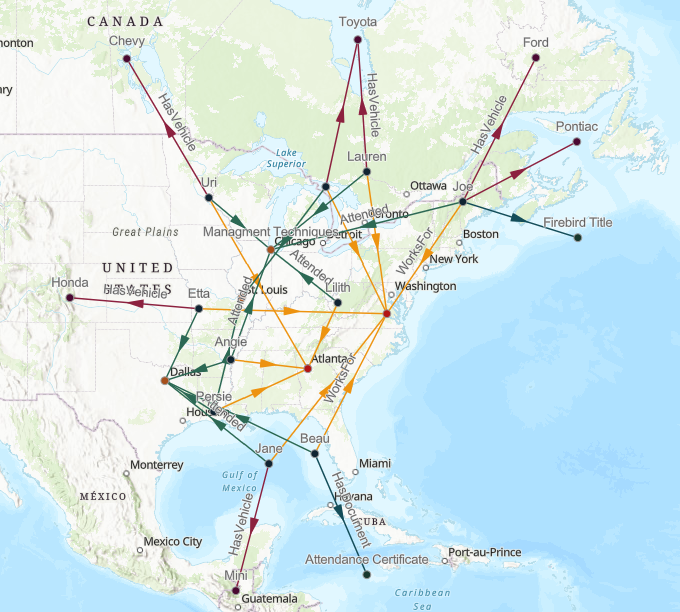

Geographic
The Geographic layout Geographic layout arranges spatial entities geographically using their geometry. Spatial entities in which the entity has a null geometry and nonspatial entities are displayed on the link chart, but their placement and arrangement are determined using the Force Directed layout.
Your organization's basemap is used by default as a backdrop to provide spatial context.
Geographic layout diagram

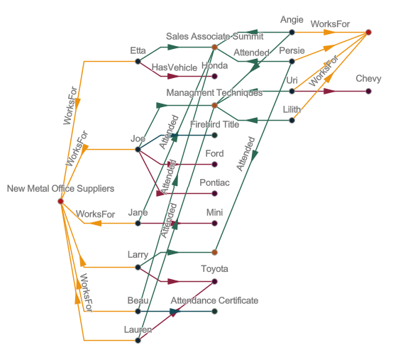

Radial Tree
The Radial Tree layout Radial Tree layout places the root entity for the tree in the center of a circle. All leaf entities for the tree are positioned around the outer edge of the circle. Entities at each level of hierarchy in the tree are arranged in concentric circles between the root entity and the outer circle.
Radial Tree layout diagram

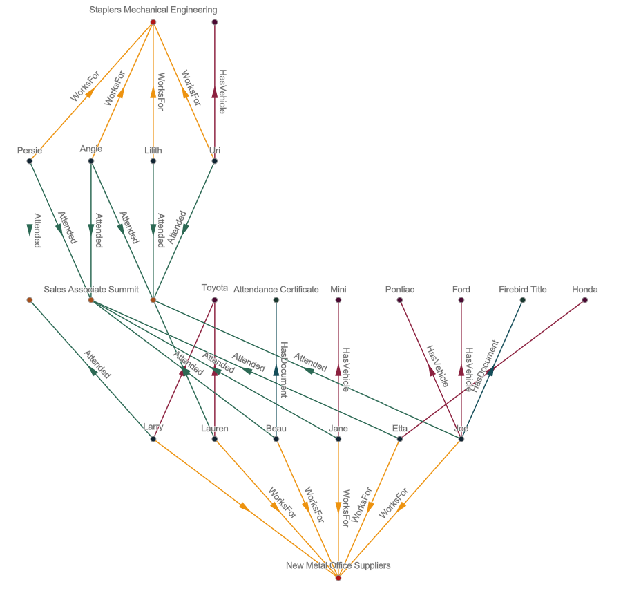

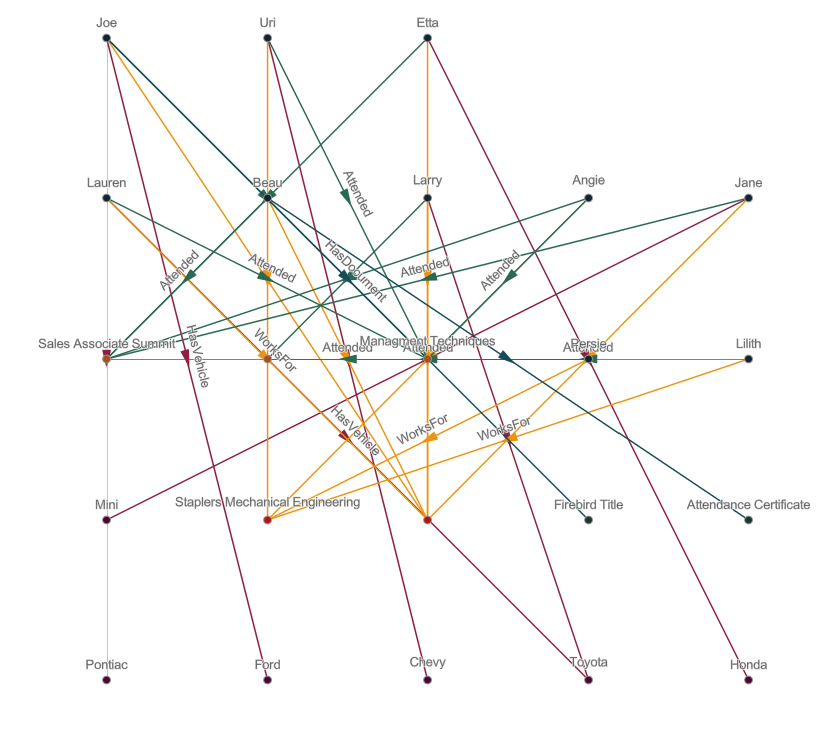

Hierarchical layouts
This group only includes the Hierarchical layout Hierarchical layout at this time. The Hierarchical layout is arranged similarly to the Radial Tree layout. However, an attempt is made to orient the majority of the relationships from the bottom to the top in which the origins for the relationship are positioned at the bottom and destination entities are positioned at the top. You can also set the root node entity when using a hierarchical layout.
The algorithm attempts to limit the number of places where the lines representing relationships cross each other. In contrast with the Radial Tree layout, relationships are not allowed between entities at the same level in the link chart with the Hierarchical layout.
Hierarchical layout diagram
Chronological layouts
Chronological layouts arrange entities and relationships using time. Entities with time properties, called event entities, and relationships with time properties, called event relationships, are arranged on one or more time lines in the order that they occurred. The entity type or relationship type must have a time property, and the layer must be time enabled for an entity or relationship to be considered an event. By default, the time direction starts with the oldest date on the left and the newest date on the right. These layouts include a time banner that shows the time intervals most appropriate for the data, the start and end of each event, and the UTC offset. Settings allow you to customize the direction of the time axis, time zone, and the placement of entities and relationships.
The following types of events are represented in chronological layouts:

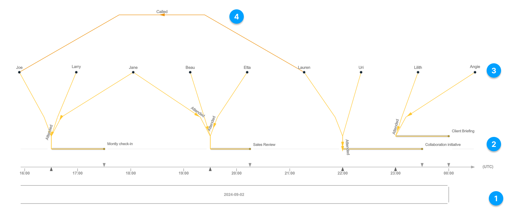

Multi-Timeline
The Multi-Timeline layout creates individual timelines for each entity related to an event. Event entities are placed between the timelines. Relationships are drawn between a timeline and the connected event entity. Relationships connecting events that have both a start time and an end time, also called durative events, have a right angle. The portion along the timeline represents the duration of the event. The layout arranges entities and relationships depending on the type of event as follows:
  • Durative entity events—The relationships have the right angle to the entity event, and are drawn on the timeline for the duration of the event.
  • Punctual entity events—Relationships are drawn in a straight line from the timeline to the event entity.
  • Durative relationship events—The relationship is drawn on both of the timelines of the nonevent entities for the duration of the event.
  • Punctual relationship events—Relationships are drawn in a straight line from the timeline to the nonevent entities.
Multi-Timeline layout diagram
The Multi-Timeline layout has various elements to communicate the relationship between events over time.
The time axis (number 1 in the image above) indicates the time direction, the UTC offset, dates and times, and the start and end of events. Events are represented on multiple timelines (number 2 in the image above). A timeline can have a timeline root (number 3 in the image above) represented at the beginning of the timeline. The timeline root is a nonevent entity that is related to events drawn on the timeline. There is at most one timeline that has no root: this timeline contains events that are not related to any entity in the link chart. Relationships between nonevent entities and nonevent entities not related to event entities (number 4 in the image above) are displayed to the outside of the timeline roots. The time scale (number 5 in the image above).
You can change the properties that arrange entities and relationships in this layout in the layout settings.
