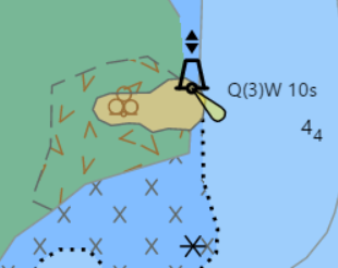

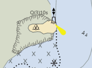

Enable custom symbology
The ServerConfiguration.xml file contains a CustomSymbology Boolean to enable or disable display of custom symbology that overrides the default S-52 presentation library. When available, Maritime Chart Service references rules in the CustomSymbolMap.xml file, Scalable Vector Graphic (SVG) symbols, and Lua scripts to provide a paper chart-like display of the S-57 data.
After setting custom symbology to True, you must rebuild the .senc files for the symbols to appear in the service.
Example of custom symbology Default S-52 presentation library
