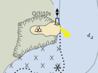

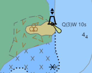

The ServerConfiguration.xml file contains a CustomSymbology Boolean to enable or disable display of custom symbology that overrides the default S-52 presentation library. When available, Maritime Chart Service references rules in the CustomSymbolMap.xml file, Scalable Vector Graphic (SVG) symbols, and Lua scripts to provide a paper chart-like display of the S-57 data.
After setting custom symbology to True, you must rebuild the .senc files for the symbols to appear in the service.
Example of custom symbology Default S-52 presentation library

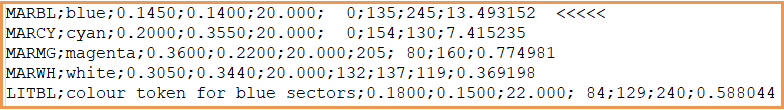

Display frames and S-52 color tokens
The Maritime Chart Service dataset frames are red, and the Custom Chart Builder dataset frames are magenta by default. In the ServerConfiguration.xml file, there are two settings that control dataset frame colors: one for Maritime Chart Service named DisplayFramesMCS and another for Custom Chart Builder named DisplayFramesPOD.
The color token values added to these properties are set using standardized S-52 color tokens. You can modify any color token value and restart the map service to review the changes. The Display Frames property found in the S52DisplayProperties.xml file is the setting that allows you to turn the dataset frames on or off.
All S-52 color token values can be found in the DAY.clr file in the colcalib folder in the controlFilesDirectory, at <ArcGIS Server installation drive>\arcgisserver\directories\maritimeserver\maritimechartservice. Back up this location if you make any changes to the DAY.clr file. Future installations may require you to overwrite this location.
All S-52 color token values can be found in the DAY.clr file under the colcalib folder in the controlFilesDirectory, at <ArcGIS Server installation directory>/usr/directories/maritimeserver/maritimechartservice. Back up this location if you make any changes to the DAY.clr file. Future installations may require you to overwrite this location.
Note:
To use the override values, you must set IntendedUsageOverrideCodes use = True and restart the map service.

Configure blue light sectors
As of S-52 Presentation Library 4.0.2, the S-52 standard does not support the display of blue light sectors. According to S-52, light sectors with COLOUR = 5 must be displayed using the color token CHMGD (Magenta). With a minor configuration change, Maritime Chart Service can display S-57 light sectors with COLOUR = 5 using a custom color token.
The custom color token is named LITBL and is found in the Maritime Chart Service .clr files used for the different color schemes, such as DAY, DUSK, or NIGHT. Maritime Chart Service has the LITBL set to the same RGB values as CHMGD by default. To display light sectors with COLOUR = 5 as blue, you must modify the RGB values for the LITBL color token in each .clr file for your implementation.
Change the RGB values for LITBL

Example of DAY.clr from Maritime Chart Service
CLR table structure
The color tables are defined in the S-52 PresLib Ed 4.0.2 Part 1 App A Colour Tables.pdf file. The values in the color tables are used in Maritime Chart Service .clr files. The .clr table contains nine columns. The first five are defined in S-52 PresLib Ed 4.0.2 Part 1.pdf section 11.4.2 Color Definition CIE-Field. There are four additional columns (Red, Green, Blue, and Conversion Error) that are created during the conversion process from CIE to RGB. You must modify the red, green, and blue values.
The .clr table columns are listed below:
  • Token—This value is referenced in the S-52 lookup tables. All features referencing this token use the defined RGB values.
  • Color—The descriptive name; however, there are many versions of a color. Some descriptive names are repeated but have different RGB values. This value can be modified if desired and does not impact Maritime Chart Service.
  • X—The x-coordinate value on the CIE color chart.
  • Y—The relative luminance value (brightest white) on the CIE color chart.
  • Luminance—The lightness value (CIE color system).
  • Red—The red value for RGB color.
  • Green—The green value for RGB color.
  • Blue—The blue value for RGB color.
  • Conversion Error—This value is ignored.
