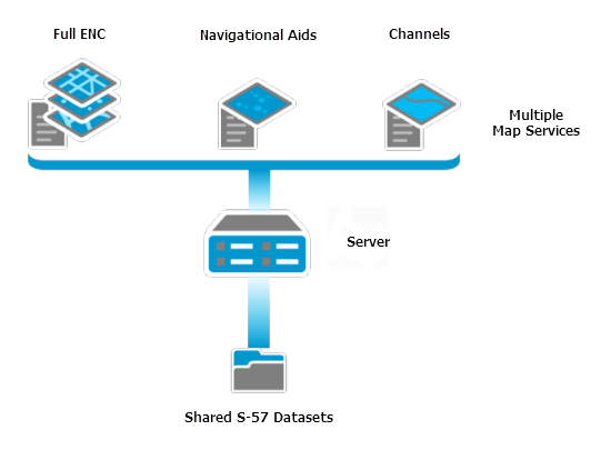

In the following image, three map services share the same S-57 datasets, but each map service has a unique set of configuration settings based on what the service uses. For example, to only provide a Navigational Aids or Channels service, you can configure your S52DisplayProperties.xml file for each map service to only show those features (layers) in your view.
Multiple services with unique configuration settings
