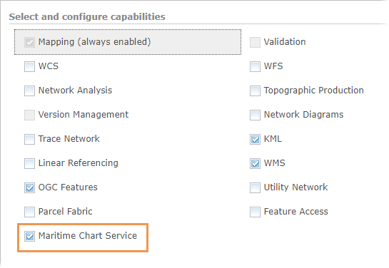

  4. Click Capabilities and check the Maritime Chart Service check box.
    Maritime Chart Service capability enabled in the Select and configure capabilities section of the Capabilities tab
