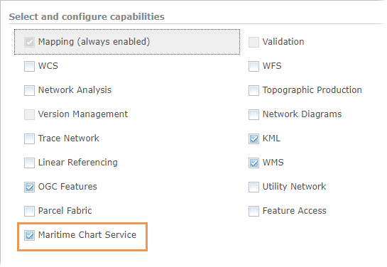

  14. Click Capabilities and check the Maritime Chart Service check box.
    Maritime Chart Service capability enabled in the Select and configure capabilities section of the Capabilities tab
  15. Verify that the Maritime Chart Service properties are configured correctly.
  16. Click Save and Restart to restart the map service.
    Maritime Chart Service capabilities are enabled.

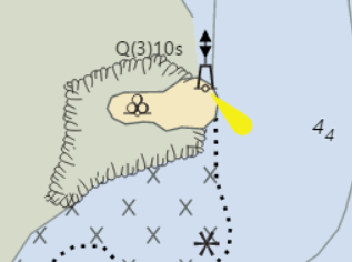

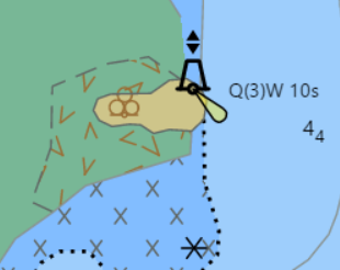

Enable custom symbology
The ServerConfiguration.xml file contains a CustomSymbology Boolean to enable or disable display of custom symbology that overrides the default S-52 presentation library. When available, Maritime Chart Service references rules in the CustomSymbolMap.xml file, Scalable Vector Graphic (SVG) symbols, and Lua scripts to provide a paper chart-like display of the S-57 data.
After setting custom symbology to True, you must rebuild the .senc files for the symbols to appear in the service.
Example of custom symbology Default S-52 presentation library
Lua in Maritime Chart Service can do the following:
  • Reference .svg files to override point symbols or line patterns (simple and complex)
  • Override symbol instructions such as color, fill pattern, or transparency
  • Access view groups or display properties
  • Provide instructions to modify a text group's font name, size, weight, color, and offset
