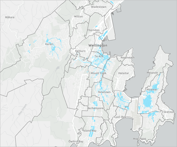

    Light gray basemap displaying Wellington, New Zealand
    The project opens with a light gray basemap centered on Wellington, New Zealand. Boundaries of local neighborhoods and suburbs are drawn in darker gray, and a flood risk zone is shown in light blue. Other layers in the Contents pane are turned off or are not visible at the current map scale (as indicated by a gray check mark).

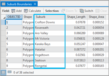

  2. In the Contents pane, right-click the Suburb Boundaries layer and click Attribute Table .
    The attribute table appears. Labels for a layer are based on values in a field of the layer's attribute table. In this case, the Suburb field will be used by default.
    Suburb Boundaries attribute table
  3. Close the attribute table. In the Contents pane, make sure the Suburb Boundaries layer is selected.
  4. On the ribbon, click the Labeling tab. In the Layer group, click Label .
    The suburbs are labeled with the names you saw in the table. On the ribbon, in the Label Class group, you can see that the labels come from the Suburb field of the layer attribute table.

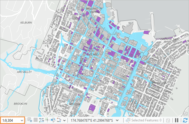

  2. On the ribbon, click the Map tab. In the Navigate group, click Bookmarks and click Te Aro.
    Map zoomed to Te Aro bookmark
    The map zooms in to the Te Aro neighborhood. The map scale is displayed in the lower left corner of the map view. (Yours may be different.) Two layers have visibility range settings:
    • Labels in the Suburb Boundaries layer display when the map scale is smaller (farther out) than 1:7,000. This is the setting you just made.
    • Features in the Building Footprints layer display when the map scale is larger (closer in) than 1:10,000. This setting was already made in the project.
  3. If necessary, on the Map tab, in the Navigate group, click Fixed Zoom In as needed until the scale threshold crosses 7,000 and the suburb labels disappear.

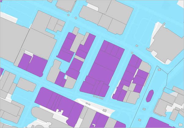

City planners are concerned about damage to historic buildings in the event of a flood. The Building Footprints layer is already symbolized to show which buildings are historic. You'll zoom in to a small area that lies within the flood risk zone and label the historic buildings with their names. By default, all features in a layer are labeled. To label just the historic buildings, you'll build an SQL query.
  1. On the Map tab, in the Navigate group, click Bookmarks and click Historic Buildings 1.
    View of buildings and flood risk zone

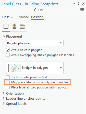

  1. In the Label Class pane, click the Position tab at the top of the pane.
    Under Position, click the Position tab if necessary.
  2. Expand Placement, if necessary.
  3. Change the Horizontal in polygon setting to Straight in polygon.
    On the map, the labels are oriented to the longest axis of their features. They now fit better within their features.
  4. Uncheck the May place label outside polygon boundary check box.
    Label Class pane with position settings
    Building labels can no longer be placed completely outside their features. However, labels are allowed to extend beyond the boundary of a feature. (You may not see any changes in your current map extent.)

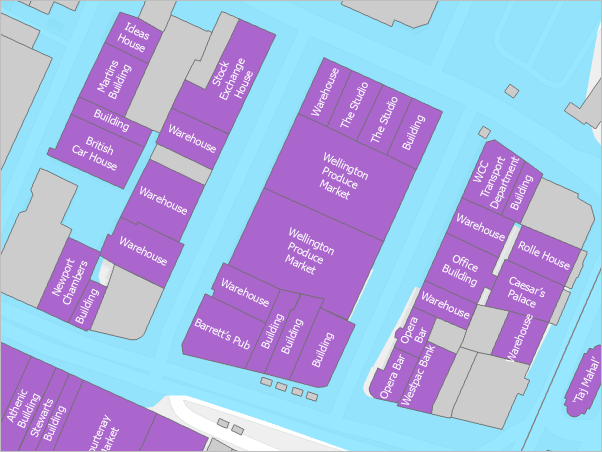

  5. On the ribbon, click the Labeling tab. In the Text Symbol group, change the text symbol font size to 8 pt and the color to Arctic White (row 1, column 1 on the color palette).
    Historic buildings with labels
    Your results may look slightly different.
    The white labels are easier to read. The smaller font size means that more labels fit completely inside the buildings.

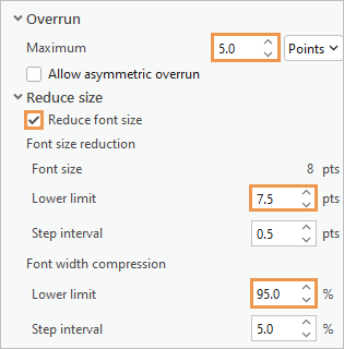

  7. Near the top of the Label Class pane, click the Fitting strategy tab .
  8. Expand Overrun and change the Maximum overrun to 5 points. Press the Enter key.
  9. Expand Reduce size and check the Reduce font size check box. Under Font size reduction, change the Lower limit value to 7.5 pts and press the Enter key.
  10. Under Font width compression, change the Lower limit value to 95 percent and press the Enter key.
    Fitting strategy settings on the Label Class pane
    The changes are applied to the map as you make them. Labels are not allowed to overrun their feature boundaries by more than 5 points. Font size and compression are adjusted slightly to make a label fit better. Labels only draw if they fit within a feature using these constraints.

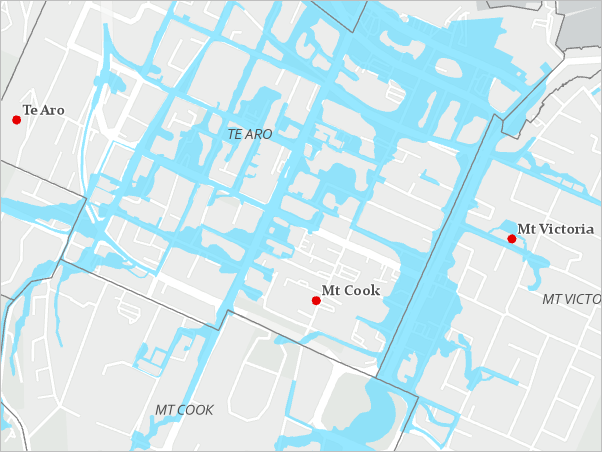

  5. In the Contents pane, right-click the Civil Defence Centres layer and click Label .
    The labels display on the map. You'll change the text symbol.
  6. On the ribbon, click the Labeling tab. In the Text Symbol group, expand the Text Symbol Style gallery. Under Scheme 2, click the Populated Place style.
    The labels update on the map.
  7. In the Label Class pane, click the Position tab in the top row of tabs if necessary. Click the Position tab under it and expand Placement.
    Tip:
    If the Label Class pane is not open, right-click the Civil Defence Centres layer in the Contents pane and click Labeling Properties .
  8. Change the placement from Best position to Bottom of point.
    The labels are placed under the features.
  9. Change the placement back to Best position.
    The Best position placement usually puts the label above and slightly to the right of the point. It uses other positions as needed to avoid conflicts with other labels or features.

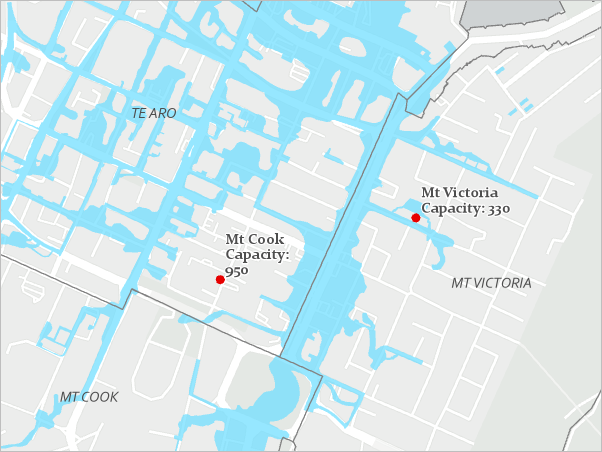

  3. In the Label Class pane, click the Class tab. Click the Label expression tab under it.
  4. If necessary, click the Language drop-down arrow and click Arcade.

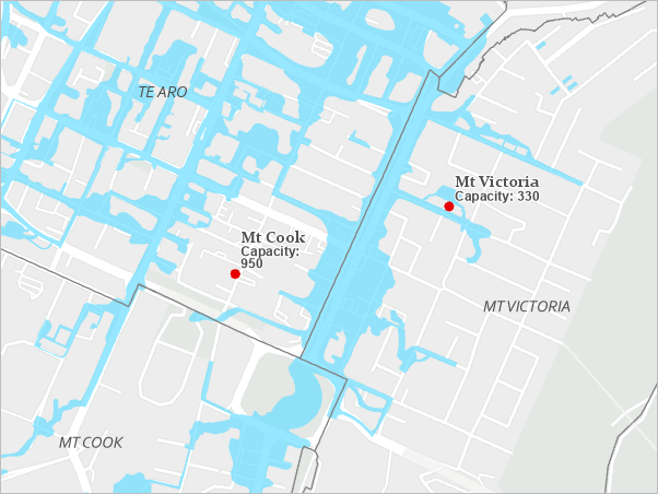

    In the Expression box, the first part of the expression, $feature.site_name, appears by default. This labels each feature with its value in the Site Name field. You'll put the word Capacity on a new line followed by the value from the Capacity field.
  5. Copy the expression below. In the Expression box, delete the current expression and paste the new expression.
    $feature.site_name + TextFormatting.NewLine + "Capacity: " + $feature.Capacity
    TextFormatting.NewLine starts a new line below the site name. "Capacity: " is added as text on the new line and $feature.Capacity adds the capacity value for each site.
  6. At the bottom of the pane, click Apply. Pan the map to view labels in different suburbs.
    Map with labels displaying capacity
    The site name and capacity both display with the same font size. You'll use a font tag to make the second line of the expression smaller.

  7. Copy the expression below. In the Expression box, delete the current expression and paste the new expression.
    $feature.site_name + TextFormatting.NewLine + "<FNT name= 'Arial' size= '9'>" + "Capacity: " + $feature.Capacity + "</FNT>"
    Text between the opening and closing font tags will display in 9 point Arial font.
    Final label expression
  8. Click Apply.
    Map with labels displaying capacity in a smaller font size

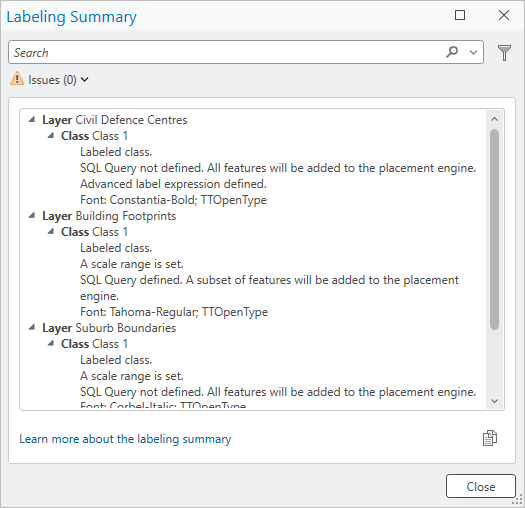

  9. On the ribbon, on the Labeling tab, in the Map group, click the More drop-down arrow and click Summary .
    Labeling Summary dialog box
    For each label class in each map layer, the Labeling Summary dialog box reports settings such as scale ranges, SQL queries, advanced expressions, and fonts. Any issues that prevent labels from displaying properly or that affect label drawing performance are shown in red text. In this case, there are no problems, as indicated by the Issues (0) message at the top.
    Learn more about the Labeling Summary report
  10. Click Close on the Labeling Summary dialog box.
