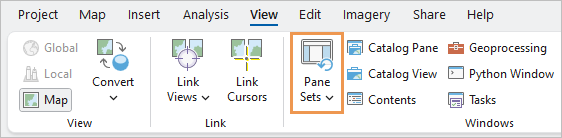

  1. In an open project, on the ribbon, click the View tab. In the Windows group, click Pane Sets .
  2. On the Pane Sets drop-down menu, choose one of the following:

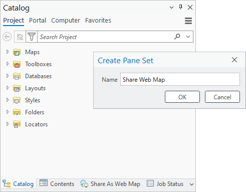

    The Create Pane Set dialog box appears.
  3. On the Create Pane Set dialog box, type a name in the Name box.
    Create Pane Set dialog box on top of several stacked panes
    In this example, the new Share Web Map pane set will open the Catalog, Contents, Share As Web Map, and Job Status panes.

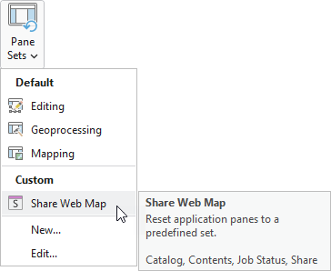

    The new pane set appears under the Custom heading on the Pane Sets drop-down menu. You can hover over it to see which panes it includes.
    Pane Sets drop-down menu and custom pane set ScreenTip
