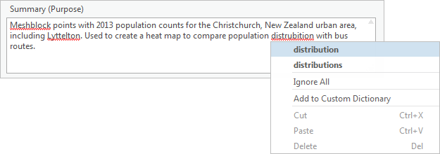

  2. In an open project, in the Catalog pane, browse to a feature class. Right-click the feature class and click Edit Metadata .
  3. In the metadata view, right-click a misspelled word and click a suggested replacement.
    A context menu shows suggested corrections for a misspelled word in an item's metadata.
    In this example, a misspelling is corrected. Other marked words may be ignored or added to your custom dictionary.
  4. On the ribbon, on the Metadata tab, in the Manage Metadata group, click Save .
    The error is fixed in the feature class metadata. It is also fixed in the layer metadata for map layers that use the feature class as a data source.

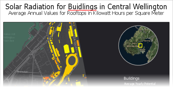

  2. In an open project, make a layout view active.
    Spelling errors in text elements are marked on the layout with wavy red underlines.
    Layout with misspelled word in title

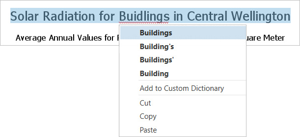

  3. In the Contents pane, or on the layout, select a text element that contains a spelling error.
  4. On the layout, right-click the selected element and click Edit Text . (Alternatively, double-click the selected text element.)
    The text element is highlighted in blue to show that it's editable.
  5. Right-click the underlined word and click a suggested replacement.
    Context menu showing suggestions for a misspelled word in a layout text element
    The spelling error is corrected and the text element is deselected.

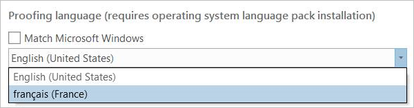

Change your proofing language
You can change the language used for proofing on the Language tab on the Options dialog box.
The list of available languages corresponds to the list of language packs for Windows installed on your computer. Use the language settings in Windows to add languages and download operating system language packs. After a new language pack is installed, the language will be available as a proofing language in ArcGIS Pro.
Note:
Ensure that the Basic typing feature is installed with the operating system language pack. This feature provides the spell-checkers and dictionaries used for proofing. To confirm that this feature is installed, check the language pack's Language Options. For more information, see Language packs for Windows.
An example of proofing languages showing English and French
