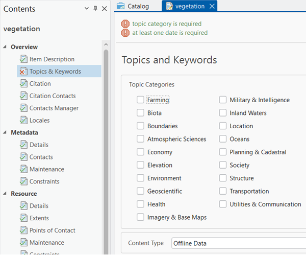

When you edit metadata using the ArcGIS Pro classic metadata editor, pages for editing metadata are loaded into the editor as specified by the selected metadata style. Each page is listed in the Contents pane.
The ArcGIS Pro classic metadata editor can have many pages in the Contents pane and show validation rules at the top of each page
The metadata style determines which metadata elements are mandatory, and which values are allowed to be recorded in those elements. If a page in the metadata editor has an element that is mandatory for the current metadata style and a value is not provided, the page has an invalid metadata icon . When you click the page in the Contents pane, validation messages appear at the top of the page.
To create a metadata record that meets the minimum requirements for the current metadata style, select each page with an invalid metadata icon and provide the content described by the validation message. When all validation errors on the page are resolved, the icon for the page changes to a valid metadata icon .

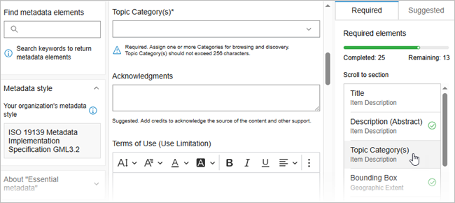

When you edit metadata using the ArcGIS metadata editor, the editor has two pages that are listed in the Contents pane: Essential Metadata and All Metadata.
The Essential Metadata page provides access to all mandatory and suggested elements for the current metadata style on one page. In the third column of the editor, the Required tab lists elements that are mandatory for the current metadata style. The Suggested tab lists elements that are recommended for creating high quality metadata but are optional for the current metadata style. If the metadata view is too narrow to show all three columns, Show required elements appears at the top, and when you click it, the Required and Suggested tabs appear in a secondary window inside the metadata view.
The ArcGIS metadata editor Essential Metadata page has three columns with required elements listed in the third column

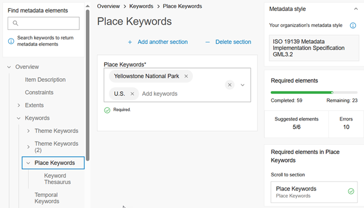

The All Metadata page provides access to all ArcGIS metadata content in a manner that is appropriate for the current metadata style. Controls that describe a specific concept are organized onto a card, and those cards are organized in a manner that is similar to the ArcGIS Pro classic metadata editor. The required elements for each card are listed in the third column.
The ArcGIS metadata editor All Metadata page has three columns with required elements listed in the third column.
If you don't know where to find a specific metadata element, type the metadata element's name into the search bar in the corner of the All Metadata page and press Enter. By default, the search results list all cards associated with the metadata element throughout the item's metadata. Click the Show hidden results toggle button at the top of the search results to include only cards associated with mandatory elements in the search results.
When you click a mandatory or suggested element in the third column on either page, the controls for providing that content scroll into view. When a suitable value is provided, a green check appears next to the element in the list and the progress bar advances indicating how close the metadata is to completion.
