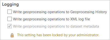

An organization may require an item's geoprocessing history to be maintained within its metadata, for example, to support legal questions for which the provenance and processing history of the data are required to provide a response. An administrator can lock the setting and prevent you from changing it on the Geoprocessing tab on the Options dialog box.
Option to log geoprocessing operations locked by administrator

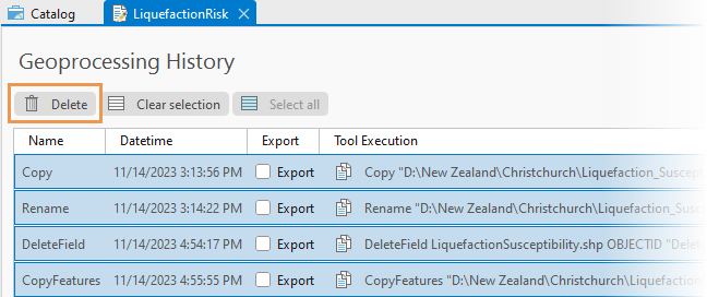

When an item's geoprocessing history negatively impacts the performance of the geodatabase as a whole, it is advisable to delete this content. When you edit an item's metadata, you can delete selected entries or all entries on the Geoprocessing History page.
Metadata tab showing selected geoprocessing history items and Delete button
