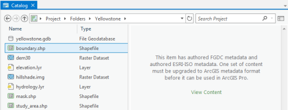

If an item has metadata in the FGDC CSDGM format, a message appears in the details panel in the catalog view indicating the metadata content must be upgraded to the ArcGIS metadata format. A stand-alone metadata XML file can have only FGDC CSDGM-format metadata content. Maps and data created with ArcGIS Desktop 9.x can have both FGDC CSDGM-format metadata content and ESRI-ISO-format metadata content in the same metadata document. When both are present, you must choose one set of metadata content to upgrade.

If the item's metadata has both FGDC CSDGM-format metadata content and ESRI-ISO-format metadata content, a message appears indicating that you need to upgrade either set of metadata content before the item's metadata can be used in ArcGIS Pro. If you upgrade the ESRI-ISO-format metadata content, the FGDC CSDGM-format metadata content remains untouched in the resulting document. The document will also contain the original ESRI-ISO-format metadata content and the upgraded content in ArcGIS metadata format.
