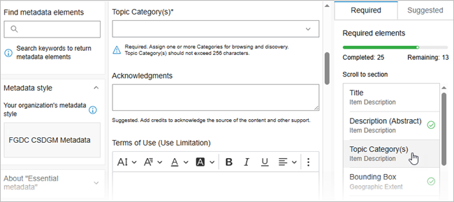

Use the ArcGIS metadata editor
Follow the steps below to create metadata that meets the requirements of the FGDC CSDGM metadata standard using the ArcGIS metadata editor.
  1. Edit an item's metadata in the metadata view.
    The metadata view appears, displaying the ArcGIS metadata editor's Essential Metadata page.
  2. Make the metadata view wide enough to see all three columns.
    The ArcGIS metadata editor Essential Metadata page has three columns with required elements listed in the third column.
  3. In the metadata editor's third column, click the Required tab.
Metadata elements that are required for the current metadata style are listed on the Required tab in the third column of the metadata editor. The name of the card on which the metadata element appears is shown below the element's name. Some elements are included on more than one card.
