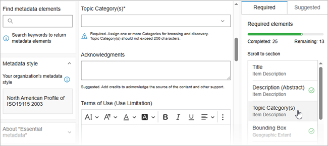

Use the ArcGIS metadata editor
Follow the steps below to create metadata that meets the requirements of the North American Profile as well as the ISO 19115 and the ISO 19139 metadata standards using the ArcGIS metadata editor.
  1. Edit an item's metadata in the metadata view.
    The metadata view appears, displaying the ArcGIS metadata editor's Essential Metadata page.
  2. Make the metadata view wide enough to see all three columns.
    The ArcGIS metadata editor Essential Metadata page has three columns with required elements listed in the third column.
  3. In the metadata editor's third column, click the Required tab.
Metadata elements that are required for the current metadata style are listed on the Required tab in the third column of the metadata editor. The name of the card on which the metadata element appears is shown below the element's name. Some elements are included on more than one card.
Each row in the table below describes one of the elements required by the North American Profile or one of the minimum mandatory ISO 19115 or ISO 19139 metadata elements. The element's name in the ArcGIS metadata editor is shown along with the metadata editor page and the card on which the element can be found. The NAP contains tables where each metadata element and the rules associated with it are defined. The numbers in the following table are the Clause numbers in those tables, identifying the appropriate row in the appropriate table for that metadata element.
Note:
The list of elements that appears on the Required tab for the NAP metadata style is incomplete in the current version of ArcGIS Pro. However, all elements required to satisfy NAP requirements and the minimum mandatory requirements for the ISO 19115 and ISO 19139 standards are included in the table below. Some information must be provided by navigating to the appropriate location on the All Metadata page. If a metadata element is listed on the Required tab but is not included in the table below, it can be skipped when you use this metadata style.
