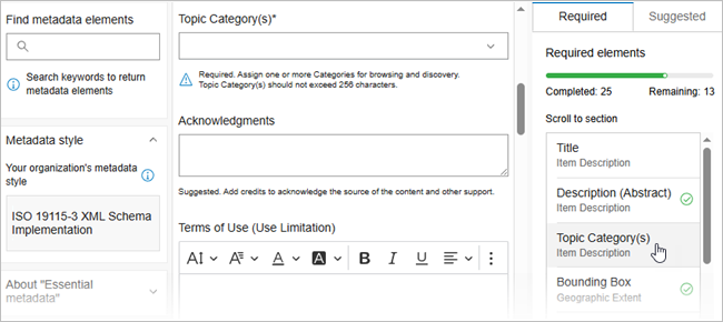

Use the ArcGIS metadata editor
Follow the steps below to create metadata that meets the requirements of the ISO 19115-1 and ISO 19115-3 metadata standards using the ArcGIS metadata editor.
  1. Edit an item's metadata in the metadata view.
    The metadata view appears, displaying the ArcGIS metadata editor's Essential Metadata page.
  2. Make the metadata view wide enough to see all three columns.
    The ArcGIS metadata editor Essential Metadata page has three columns with required elements listed in the third column.
  3. In the metadata editor's third column, click the Required tab.
Metadata elements that are required for the current metadata style are listed on the Required tab in the third column of the metadata editor. The name of the card on which the metadata element appears is shown below the element's name. Some elements are included on more than one card.
Each row in the table below describes one of the minimum mandatory ISO 19115-1 metadata elements. The element's name in the ArcGIS metadata editor is shown along with the metadata editor page and the card on which the element can be found. The requirements column identifies the same metadata elements by the names used in the ISO 19115-1 metadata standard.
