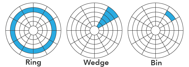

A data clock is a circular chart that divides a larger unit of time into rings and subdivides it by a smaller unit of time into wedges, creating a set of temporal bins.
Data clock ring, wedge, and bin

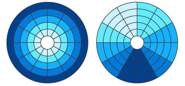

Bins are symbolized using graduated colors that correspond to a count or summarized value taking place in each time period. Overall temporal trends can be examined by noting if the concentric rings change value over time (moving from the center of the circle outward), and seasonal or cyclical patterns can be examined by noting if the wedges vary in value around different parts of the circle.
Data clock temporal trend (left) and seasonal pattern (right)
The data clock on the left shows a temporal trend of increasing intensity over time, and the data clock on the right shows a seasonal pattern where intensity is consistently high in a few wedges.

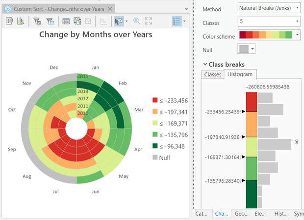

Bins are symbolized using a classified color scheme. A color classification Method, number of Classes, and Color scheme can be adjusted on the Data tab in the Chart Properties pane.
Data clock classification histogram

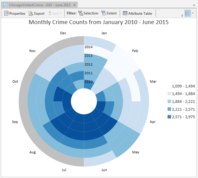

Create a data clock to visualize trends and seasonality of crimes in Chicago from January 2010 through June 2015.
  • Date—Date
  • Rings—Years
  • Wedges—Months
  • Aggregation—Count
Data Clock showing monthly trends in violent crime in Chicago, January 2010 through June 2015
