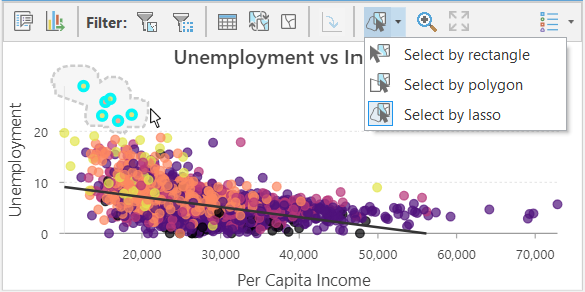

  1. Ensure your chart is in select mode by clicking the Select Mode button in the chart window.
  2. Use one of three selection tools in the selection drop-down menu to make a selection in your chart.
    • Rectangle Active Select—Click a chart element, or click and drag the rectangle across the chart.
    • Polygon Active Select Polygon—Click in the chart to create the vertices of the polygon. Double-click to close the polygon and complete the selection.
    • Lasso Active Select Lasso—Press and hold the left mouse button and draw with the pointer to create a freehand shape in the chart.
  3. To clear the selection, click a blank area of the chart, or click the Clear selection button in the chart window.
Three selection tools in the selection drop-down menu

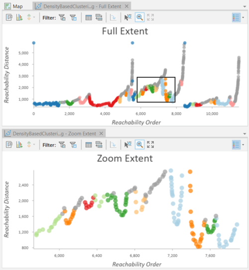

Zoom can be used to examine part of a chart in more detail. To zoom in to an area in your chart, do the following:
  1. Ensure your chart is in zoom mode by clicking the Zoom Mode button in the chart window.
  2. Click and drag to create a rectangle around the area of interest.
    Chart full extent and zoom extent
  3. To pan, click and drag the mouse wheel button.
  4. To return to the chart's full extent, click the Full Extent button in the chart window.

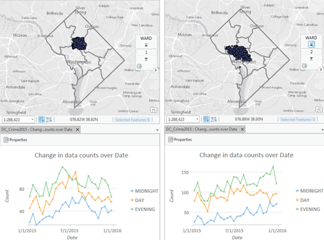

Charts, like maps and tables, do not display features out of the current range or query applied to the source layer. You can visually filter charts using the range slider, time slider, definition queries, or any combination of the three.
In the following example, a range slider was used to filter crimes in Washington, D.C., based on ward number. As the ward number changes, the map and chart update to show only crimes that took place in the specified ward.
Line chart filtered by range slider.

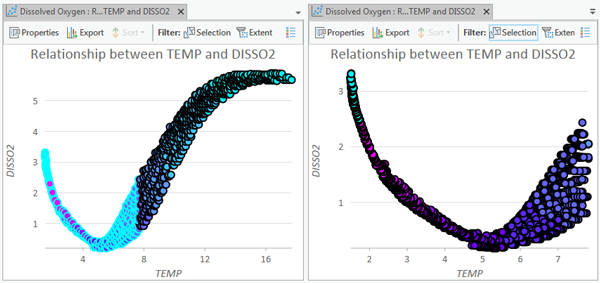

When Filter by Selection is enabled, the chart only draws features that are currently selected. The selection can be made in the map, the attribute table, or another chart created from the same layer.
Filter by Selection can be used as a way to zoom in to a chart. To do this, create two identical charts and set one of them to filter by selection. Then, when you make a selection in the unfiltered chart, the filtered chart will zoom to only that area that has been selected.
Filter by Selection focuses on an area of interest in a scatter plot.
The chart on the right shows only the selection subset from the chart on the left.

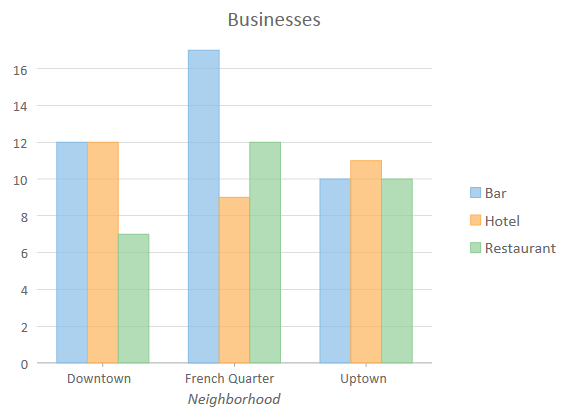

Legend
Some charts include a legend to distinguish between series or to display statistical information. You can click an item in the legend to turn it on and off in the chart.
Chart series shown in a legend.
A bar chart series is shown in a legend.
