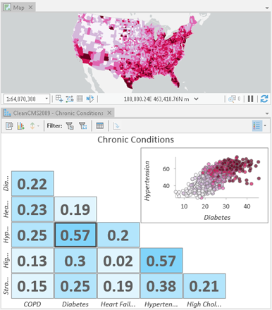

Example
Create a scatter plot matrix to visualize the relationships between several chronic conditions and identify which correlations are strongest using the following properties:
  • Numeric fields—COPD, Diabetes, Heart Failure, Hypertension, High Cholesterol
  • Lower left—R-Squared
  • Upper right—Preview Plot
Scatter plot matrix
