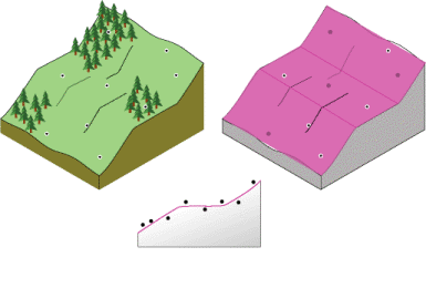

A first-order global polynomial fits a single plane through the data; a second-order global polynomial fits a surface with a bend in it, allowing surfaces representing valleys; a third-order global polynomial allows for two bends; and so forth. However, when a surface has a varying shape—such as a landscape that slopes, levels out, and slopes again—a single global polynomial will not fit well. Multiple polynomial planes would be able to represent the surface more accurately as shown in the following illustration:
Local Polynomial interpolation
Local Polynomial interpolation illustration
