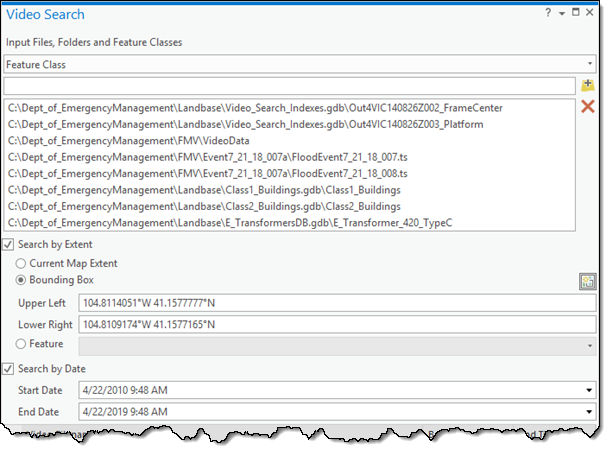

Input files, folders and features
To conduct a search, you must specify one or more metadata compliant videos, either individual video files or a directory of video files. Under Input Files, Folders and Feature Classes, click the drop-down arrow to select the type of input to add to the search operation:
Folder—Specify one or more folders containing video files. There are 12 supported video formats.
Video—Specify one or more video files. There are 12 supported video formats.
Feature Class—Specify one or more feature classes to be used to define the search. Video frames intersecting any of the features specified will be identified as candidates for the search results.
The type of input you specify determines the type of files you can specify. The files or directories you specify are listed in the input window of the tool. You can specify multiple folders, videos, and feature classes. Delete any search inputs by selecting the entry in the input window and clicking the Delete button
Search by extent
You have four options to search by geographic extent:
Search Frame Extent—Right-click within the video player display and select Search Frame Extent to capture and transfer the video frame coordinates to the Video Search pane.
Current Map Extent—Determined by the current extent of your map display.
Bounding Box—Determined by drawing a bounding box on your map display. Click the Draw Bounding Box tool
and draw a box on the map display. The geographic map coordinates of your bounding box will be displayed. You may redraw the bounding box multiple times; only the coordinates of the most recent bounding box are retained as your spatial extent.Feature—Click the drop-down arrow to select a feature class layer loaded into the map and displayed in the Contents pane. This allows you to search arbitrary shapes, rather than just a rectangular extent.
Search by time range
Refine your search by specifying a date and time range. Check the Search by Date check box and specify a start and end date and time sequence. All video segments with time stamps within the specified time range will be identified as search candidates.

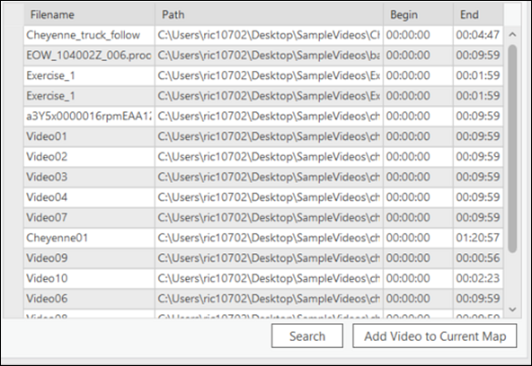

When you are satisfied with all of your video file search criteria, click the Search button at the bottom of the Video Search dialog box to search. The tool will extract the metadata from the video files and store it in a feature class in the project geodatabase. You can customize where the cached search metadata data is stored by specifying the geodatabase. Click Standalone Video group > Data > Manage > Configure Workspace > Workspace > Default Video Search Feature Class. The footprints and associated time stamp data are compared against the search criteria to identify matches.
The video files—and segments within the video files—meeting the specified search criteria will be listed in the search results window. The video segments identified in the results window meet all of the specified search criteria. If video segments meet some but not all of the search criteria, they will not be displayed in the results window. The directory path and video file name are listed along with the beginning and ending time stamp of the identified segment within the video file.
You can load any of the videos listed on the video search results window into the map display. Highlight the video file in the list, and click Add Video to Current Map. The video will be loaded into a new video player, queued to the start and end of the segment meeting the search criteria.
