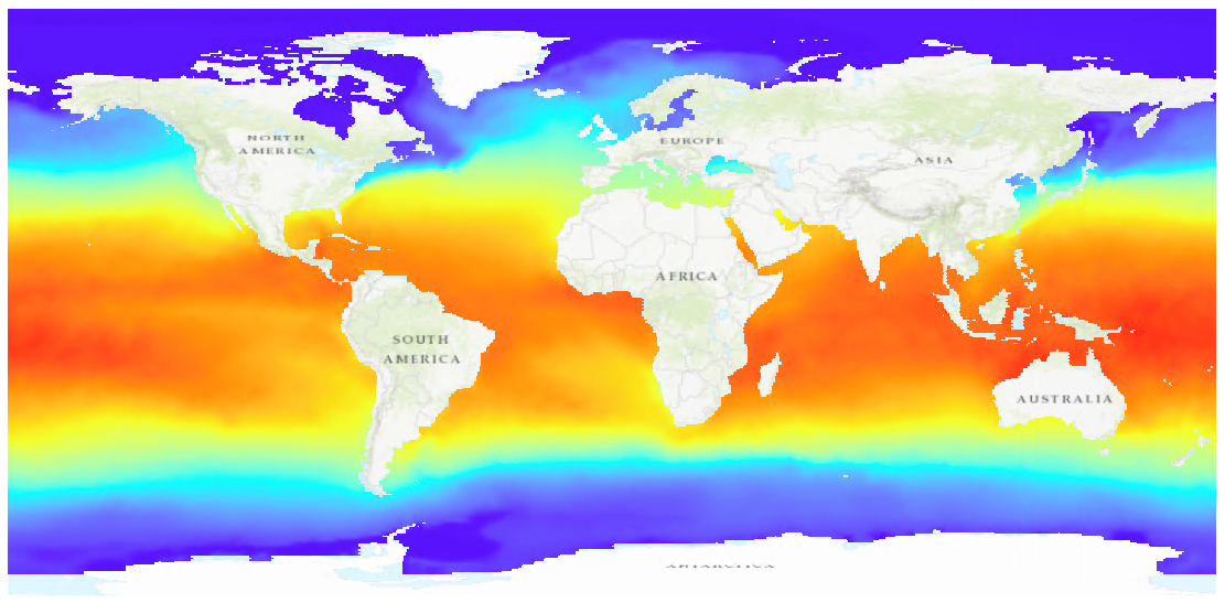

    The netCDF layer displays sea surface temperature globally.

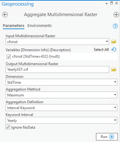

  1. On the Multidimensional tab, in the Analysis group, click the Aggregate button to open the Aggregate Multidimensional Raster geoprocessing tool.
    This tool combines slices from an existing multidimensional dataset along a dimension to generate a new CRF multidimensional raster.
    Note:
    If the ArcGIS Image Analyst extension has not been licensed for ArcGIS Pro, you cannot access these tools.
  2. Enter the parameters as follows:
    1. For Input Multidimensional Raster, select CFSR_sst.nc.
    2. Under Variables, check the cfsrsst [StdTime=432] ((null)) check box.
    3. For Output Multidimensional Raster, select YearlySST.crf.
    4. For Dimension, select StdTime.
    5. For Aggregation Method, select Maximum.
    6. For Aggregation Definition, select Interval Keyword.
    7. For Keyword Interval, select Yearly.
    8. Check the Ignore NoData check box.
    Aggregate Multidimensional Raster dialog box
  3. Click Run.
    The result is a multidimensional raster dataset, in .crf format, containing the yearly maximum sea surface temperature value for every pixel and for every year in the dataset.

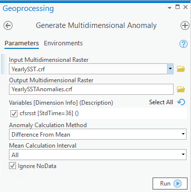

  5. Click the Back button in the Geoprocessing pane to go back to the menu. Open the Generate Multidimensional Anomaly tool from the Multidimensional Analysis toolbox.
    This tool generates a CRF multidimensional raster depicting, for each year, the difference in temperature between each pixel and the global average for that year.
  6. Enter the parameters as follows:
    1. For Input Multidimensional Raster, select YearlySST.crf.
    2. For Output Multidimensional Raster, select YearlySSTAnomalies.crf.
    3. Under Variables, check the cfsrsst StdTime=36 check box.
    4. For Anomaly Calculation Method, select Difference From Mean.
    5. For Mean Calculation Interval, select All.
    6. Check the Ignore NoData check box.
    Generate Multidimensional Anomaly dialog box

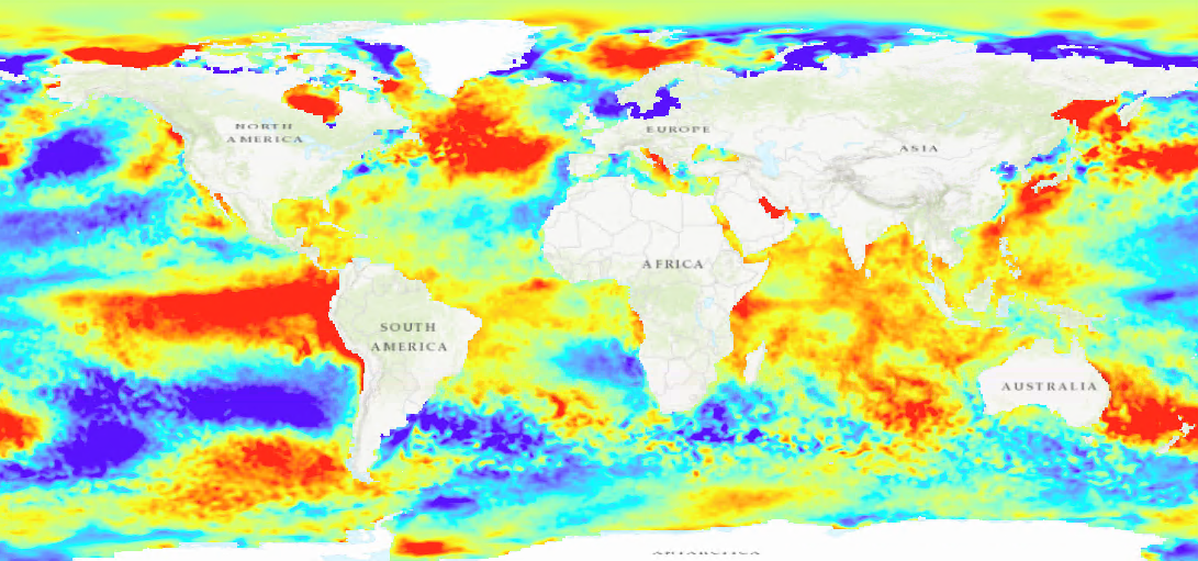

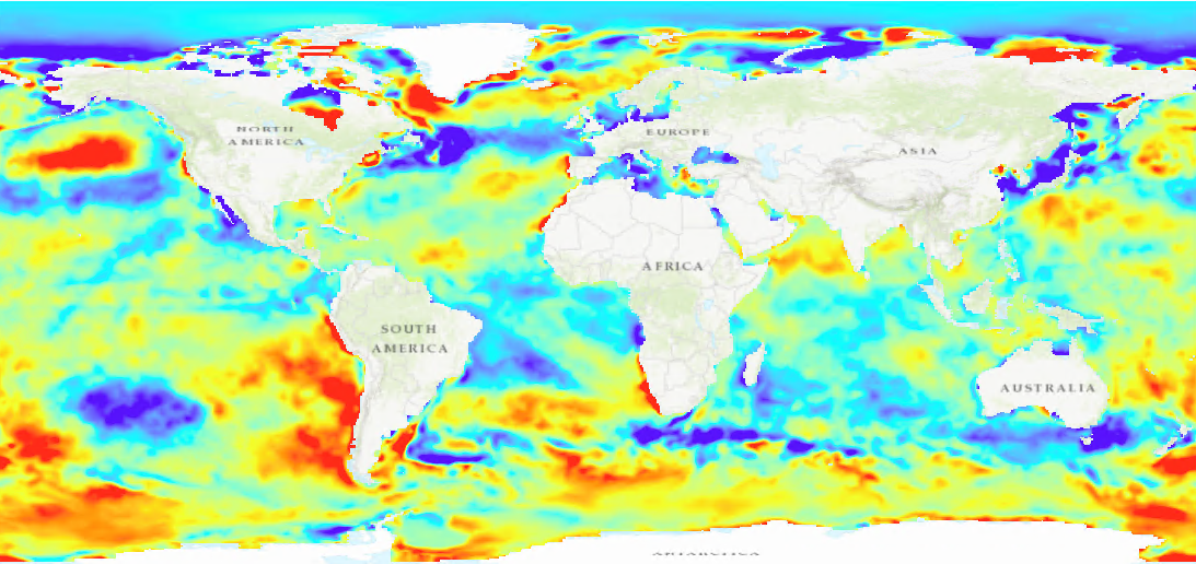

  8. With the YearlySSTAnomalies.crf layer in the Contents pane, open the Appearance tab under the Raster Layer contextual tab on the ribbon. In the Rendering group, click the Stretch Type drop-down list, and select Standard Deviation.
    The result is a multidimensional raster dataset, in .crf format, where pixels in red indicate maximum yearly temperatures that were higher than the global mean sea surface temperature in that year. Pixels in blue indicate temperatures lower than the global mean.
    Maximum yearly sea surface temperature anomalies

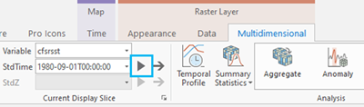

  2. In the Current Display Slice group, click the Play Slices along StdTime button to see the display update for each year in the dataset.
  3. Set StdTime in Current Display Slice to 1998-01-01T00:00:00 - 1998-12-31T23:59:59 to see yearly temperature anomalies for 1998.
    Sea surface temperature anomaly in 1998-1999
    A large red region appears off the west coast of South America. The anomaly stretches across the Pacific Ocean, showing an area where the maximum temperatures were much higher than the global ocean temperature.

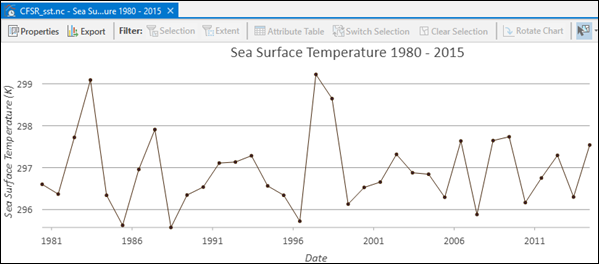

  4. Right-click the CFSR_sst.nc layer, select Create Chart, and choose Temporal Profile.
    The Chart Properties pane appears, and the chart window appears at the bottom of the project.
  5. Configure the temporal chart:
    1. Click the point button under Define an area of interest. Place a point in the Pacific Ocean in the large red region described above (near 84.2696°W 4.433006°S).
    2. Under Time binning options, change Interval size to 1 Years.
    3. If necessary, under All locations, use the drop-down menu under the Variable column to select cfsrsst.

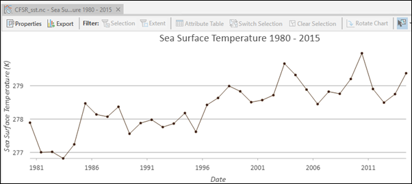

    The chart updates with the temporal profile for the point location across 36 years of data. You can further configure the chart using the Axes, Guides, Format, and General tabs at the top of the Chart Properties pane.
  6. In the Time format section, for Date Format, choose (yyyy) or 2020 (yyyy). For Time Format, choose <none>.
  7. Click the General tab in the Chart Properties pane. Change the chart title to Sea Surface Temperature 1980 - 2015. Change the x-axis title to Date and the y-axis title to Mean Sea Surface Temperature (K).
    Sea surface temperature chart for central and east-central Pacific
    Notice the maximum temperature was much higher in two years than other years. Hover over the two points to see that 1983 and 1997 were two years with higher-than-average temperatures.
    These two years, and the large red region in the anomaly data, correspond to two El Niño events, in which a band of warm ocean water develops in the central and east-central Pacific region.

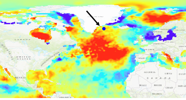

  8. Click the point feature button again and this time add a point in the waters off the southeast coast of Greenland (near 32.997154°W 64.789142°N).
    Place a new point off the coast of Greenland.
