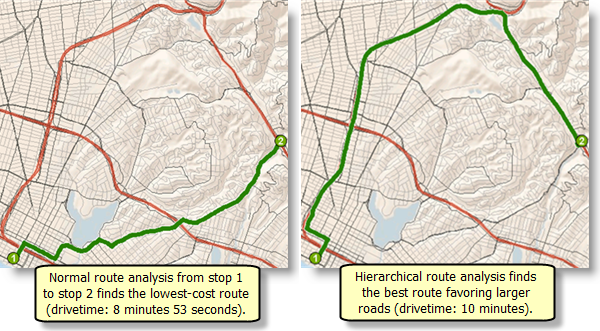

A comparison of a nonhierarchical route analysis and a hierarchical route analysis

Even when you have the option of performing a hierarchical analysis, you can choose to ignore hierarchies. You should base your decision on your data and your particular network problem. If you aren't sure, run the analysis with and without the hierarchy, compare the results, and decide which results are the best fit for you.

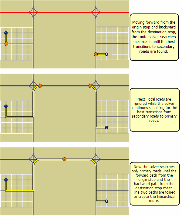

How hierarchy works
Hierarchical network analysis works by progressively reducing the number of roads to search to those in the higher levels of the hierarchy. The route solver begins by simultaneously traveling forward from the origin stop and backward from the destination stop. Local roads are searched until the best transitions to secondary roads are found, from which point only secondary and primary roads are searched. The solver continues on secondary roads until the best transitions to primary roads are found. The solver then only searches primary roads, ignoring roads in the lower hierarchical classes, until the path from the origin meets the path going backward from the destination, thereby connecting the origin and destination and finding a route.
The objective of the solver is to minimize impedance while favoring a higher order of hierarchy. The following graphic demonstrates how the hierarchical solver functions:
Steps of the hierarchical solver

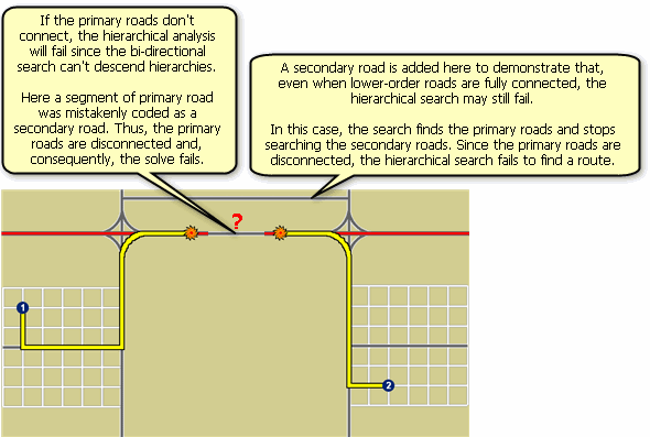

If you place a barrier on a route that uses hierarchy, the solver tries to find an alternate course by either temporarily descending the hierarchy and proceeding around the barrier or finding a different path—depending on which is shorter.
If the highway is disconnected, the route solver does not descend to the local street and connect. Instead, an error is returned. ArcGIS assumes that the highest order of hierarchy is connected.
Disconnected hierarchy example
