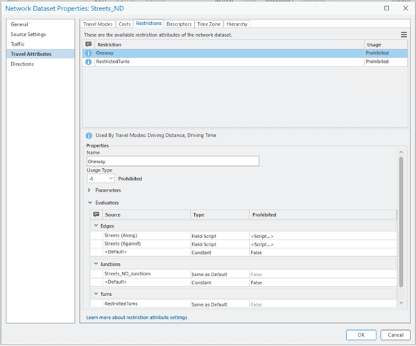

Properties
The Restrictions tab displays the restriction attributes that are available with the network data source in the upper section, and in the lower section, properties associated with the selected restriction are displayed.
Restrictions tab
The Properties section displays how the selected restriction is configured. It lists the metadata associated with the restriction attribute and the details on how the parameters and evaluators are configured.
The following are the restriction attribute properties:
  • Name—The name of the restriction attribute.
  • Usage Type—The usage type of the restriction attribute. This specifies whether the restriction attribute prohibits, avoids, or prefers the network elements if the evaluator value is True.
  • Parameters—These are placeholders for values that you can change for a particular analysis. They each have a meaningful default value that can be overridden when necessary.
    Learn more about parameters
  • Evaluators—Each attribute defined in the network must provide values for each source and direction (along and against for edges) participating in the network. An evaluator assigns values for the attribute of each source and travel direction, and a default evaluator for each element is used for those sources and directions that do not have an assigned evaluator for an attribute.
    Learn more about evaluators
