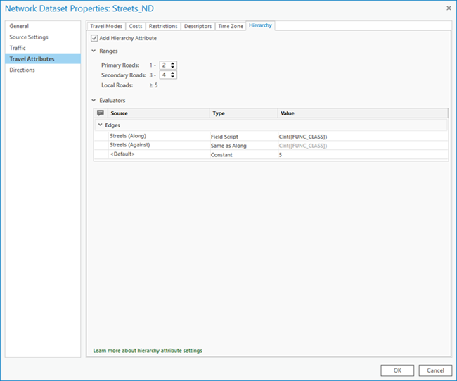

The Hierarchy tab allows you to configure properties for performing a network analysis that makes use of hierarchy.
Hierarchy tab
  • Add Hierarchy Attribute—Check this check box if you want to use hierarchy while doing analysis. For your analysis to use a hierarchy attribute, you need to use a travel mode that turns hierarchy on. Checking the Add Hierarchy Attribute check box on the hierarchy page adds a hierarchy attribute so your travel mode can decide whether to use it. If your network dataset doesn't have a hierarchy attribute, the Use Hierarchy check box in the Advanced section on the Travel Modes tab is unavailable.
  • Ranges—Use ranges to classify your various hierarchy levels on the streets into three categories: primary roads, secondary roads, and local roads. If you have a hierarchy attribute and intend to use a turn category evaluator, you need to specify ranges.
  • Evaluators—Each attribute defined in the network must provide values for each source and direction (along and against for edges) participating in the network. An evaluator assigns values for the attribute of each source and travel direction, and a default evaluator for each element is used for those sources and directions that do not have an assigned evaluator for an attribute.

  1. Access network attributes on the Network Dataset Properties dialog box.
  2. Click the Hierarchy tab.
  3. Check the Add Hierarchy Attribute check box.
  4. If necessary, expand the Ranges section.
  5. Define the ranges for the primary, secondary, and local roads.
  6. In the Evaluators section, assign an evaluator to the source features.
