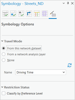

Symbology options
The Symbology Options button allows you to show network symbology by a travel mode and the restriction status preference level.
Choose the travel mode source to be a network dataset or a network analysis layer and restriction status preference level.
Travel mode
In the Travel Mode section, you can choose the source of your travel mode to come from the network dataset or from a network analysis layer.
  • From this network dataset—When this option is selected, you can choose the available travel modes from the Name drop-down list to be used for symbolizing the elements.
  • From a network analysis layer—When this option is selected as the source, you can choose the network analysis layer from the Layer drop-down list that contains all the network analysis layers in the map that share the same local network data source. The Name option is disabled, and displays the name of the travel mode from the selected network analysis layer. If the symbolized network dataset layer is using a network analysis layer as the source for its travel mode, the travel modes of the network dataset layer and source network analysis layer can become out of sync with each other. This can happen if the travel mode of the network analysis layer is edited outside of the Symbology pane using its ribbon or property page. When this happens, you should receive a warning message. To resynchronize the network dataset layer with its source travel mode, browse to Symbology Options in the Symbology pane and run the Refresh command.
  • None—Not using a travel mode.
Restriction status
The traversable elements can be classified using more fine-grained symbolization of the actual preference level by selecting the Classify by Preference Level option.
  • Classify by Preference Level (unchecked)—This is the default. The network elements will be symbolized as Traversable, Prohibited, and Error.
  • Classify by Preference Level (checked)—The network elements will be classified as Neutral, Avoid, Prefer, Mixed (for edges), Prohibited, Error. The traversable element will be classified as one of the following: Neutral, Avoid, Prefer, Mixed (for edges).

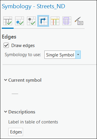

  3. Select the category that you want to draw on the map. For example, select the edges category and click Draw edges.
    By default, the category will use Single Symbol from the Symbology to use drop-down list and therefore you will see under Current symbol, there's only one symbol used for all the edges.
    Single symbol assigned to all the edges.

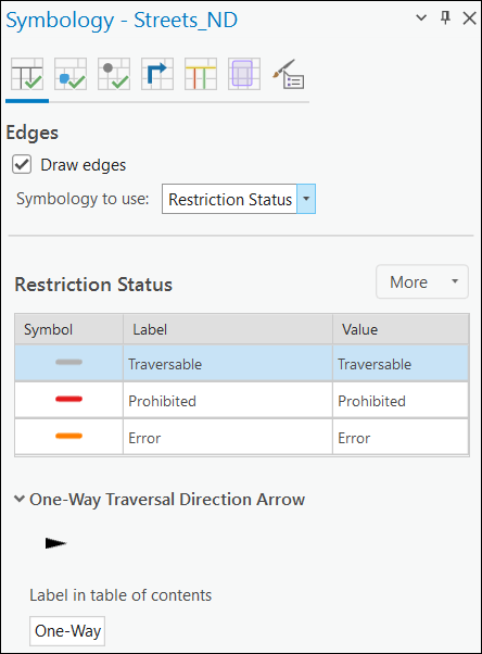

  4. To assign the symbology based on the restriction status of the edges, from the Symbology to use drop-down list, choose Restriction Status.
    The Symbology pane updates with the symbols assigned to each restriction status to the edge category.
    Edges are symbolized using their restriction status.
  3. Choose the category you want to customize.
  4. If needed, check the draw category check box—for example, Draw edges—to turn on the visibility of the source category.
    To change the symbology of the single symbol, follow steps 5 through 8. To customize the symbology based on the restriction status, skip to step 9.
  5. To change the symbology, click the symbol under the Current symbol section.
    The Symbology pane now has options to customize the symbol.
  6. Make the necessary changes and click the Apply button at the bottom.
    The symbology changes for the selected category.
  7. Click the Back button to return to the Symbology pane.
  8. If needed, change the label of the category by typing in the text box under Descriptions.
    To customize the symbology based on the restriction status, follow steps 9 through 11.
  9. From the Symbology to use drop-down list, choose Restriction Status.
  10. In the Restriction Status section, click the Symbol to customize the symbol.
  11. Optionally, click Label to customize the label.
    The Contents pane is updated with the customized symbol and label.
