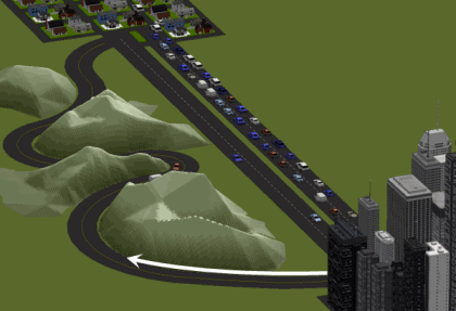

A quickest route against traffic
At 8:00 a.m., commuter traffic to the city is heavy, but traffic to the suburbs is light; therefore, the quickest route from the city to the suburbs at this time is along the divided highway.

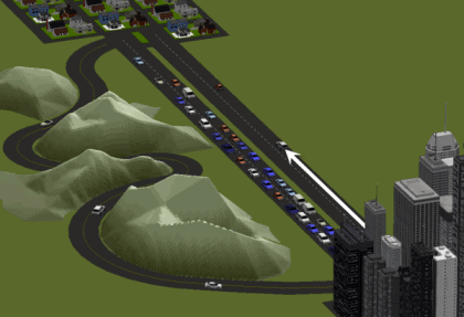

A quickest route avoiding traffic delays
At 5:00 p.m., commuters are driving home from the city, which increases the travel time in that direction. Travel has become slow enough on the divided highway that the serpentine alternative now offers a quicker route to the suburbs.
