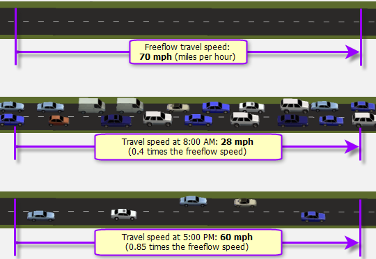

To better understand this traffic model, assume you need to use it to record and store travel speeds for a one-way street segment over the course of a week, starting on Monday. First, you would determine the free-flow speed, which is the speed a vehicle travels when no other traffic is impeding its movement. The method you use to determine the free-flow speed is your choice, but it is typically the speed limit or the observed, average speed of cars that pass by when other vehicles aren't present. Say you choose the observed, average speed of cars and establish the free-flow speed is 70 miles per hour.
Now you can make observations throughout the day at equal time intervals, or time slices. The intervals you choose give your data its temporal resolution. You could choose 1-hour intervals, 10-minute intervals, and so on. Say you choose 5-minute intervals. Your observations are recorded as scale factors of the free-flow speeds. The scale factors are limited to a range of zero to one. Assume you observe cars traveling 28 miles per hour at 8:00 a.m. This is 0.4 times the free-flow travel speed. At 5:00 p.m., the average speed is 60 miles per hour, which is about 0.85 times the free-flow travel speed. At 11:00 p.m., there are few cars on the road, and their average speed is 70 miles per hour, which is equal to the free-flow travel speed—the scale factor is one.
Travel speed observations
Once your observations for the day are completed, you need to reference a table of traffic profiles and choose the one profile that best matches the observed variation of relative speeds throughout the day.

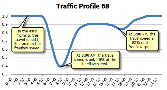

You choose traffic profile 68 (plotted in the graph below) to represent the segment's travel time on Mondays.
Observations plotted on a graph
Traffic profile 68 is chosen because it has relative travel speeds that are similar to those observed on the street segment.

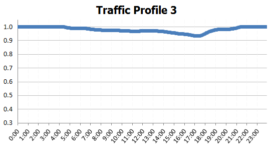

The Saturday and Sunday traffic on your segment is light and steady, so you choose Traffic Profile 3 (below) to represent travel times on the weekends.
A traffic profile that fits a road segment's weekend travel speeds

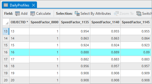

Profiles table
Each record in a traffic profiles table has a unique identifier and several fields for storing the free-flow scale factor at different times of the day. The times of the day are split into time intervals, or time slices, which must be of equal duration and, thus, split a 24-hour period into equal intervals. For instance, if the time slices are 5 minutes in length, there are 288 fields (one for 12:00–12:05 a.m., 12:05–12:10 a.m., and so on).
The San Francisco geodatabase in the Network Analyst tutorial data has profiles that cover the day in 5-minute time slices. The SpeedFactor_0000 field contains the free-flow scale factors for midnight to 12:05 a.m. The SpeedFactor_1140 field contains the multipliers for 11:40 a.m. to 11:45 a.m. When a street feature is related to a profile, you can get its expected travel time for any time of the day. For example, if a street is related to profile 16, which is shown in the following image, you can calculate the expected travel time at 11:41 a.m. by multiplying the street's free-flow travel time with the profile's SpeedFactor_1140 value (0.889).
Excerpt from a profiles table

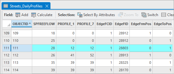

An example of a Streets-Profiles table is the table entitled Streets_DailyProfiles in the following screen shot. The field, PROFILE_1, represents Sunday Profile Field; PROFILE_7 represents Saturday Profile Field; and PROFILE_2 through PROFILE_6 (not shown) represent the Monday through Friday Profile Fields.
The selected record (ObjectID 111) relates profiles for each day of the week with the from-to side of the street feature that has an object ID of 28803. The from-to direction of the street is identified by the EdgeFrmPos and the EdgeToPos values, which are respectively zero and one. Traffic profile 12 represents that side of the street on Sundays and Saturdays, since 12 is the value in the PROFILE_1 and PROFILE_7 fields. The SPFREEFLOW field indicates the travel speed for the street in the from-to direction under free-flow conditions.
The first record (Object ID 109) stores the profiles for a street segment in the to-from direction, and the second record (Object ID 110) stores them for the same street segment in the opposite direction. This is inferred from the EdgeFCID and EdgeFID values, which are identical, and the EdgeFrmPos and EdgeToPos values, which are reversed. Notice that their Sunday and Saturday Profile Field values are zero. This means data wasn't collected or a profile wasn't chosen for those days. When evaluating Saturday or Sunday historical travel times for that edge, the evaluator will need to fall back to a secondary cost attribute defined in the edge traffic evaluator.

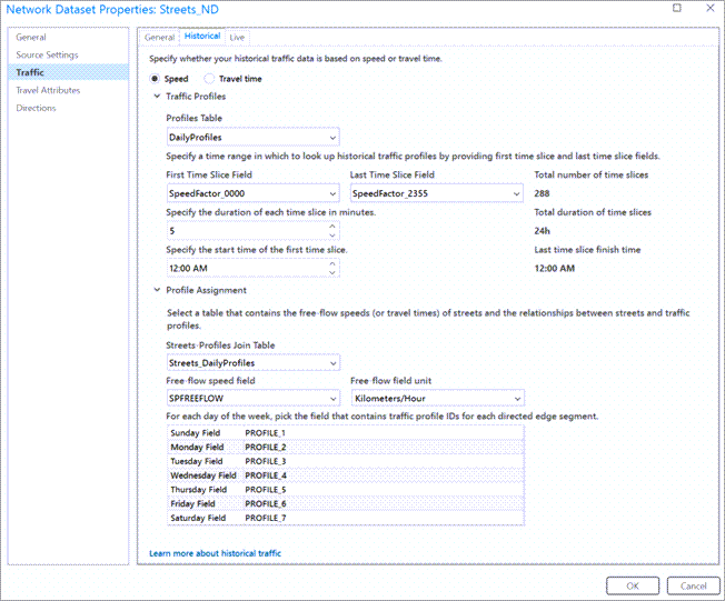

Follow the steps below to modify a network's historical traffic settings:
  1. Open the Network Dataset Properties dialog box.
    Learn how to open the Network Dataset Properties dialog box
  2. Click Traffic.
    Two tabs, Historical Traffic and Live Traffic, appear. However, if the network dataset you're using was not configured to support traffic at the time it was created, these tabs will be unavailable.
  3. Click the Historical Traffic tab.
  4. Specify whether your historical traffic data is based on speed or travel time.
    Traffic profiles based on travel time must have values of 1 or greater, since 1 represents free-flow times and any scale factor larger than that indicates longer travel times. In contrast, when profiles are based on travel speeds, the scale factors must be between 0 and 1, with 1 representing free-flow traffic speeds. As the scale factor approaches zero, the speeds also approach zero.
  5. Set the properties in the Traffic Profiles section.
    Learn more about the traffic profiles table properties
  6. Set the properties in the Profile Assignment section.
    Learn more about the profile assignment properties
  7. Click OK.
    Changes are saved to the network dataset.
