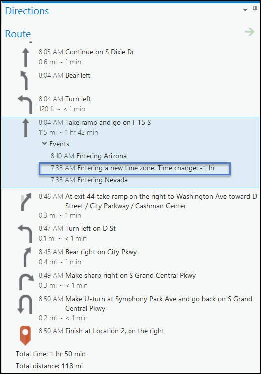

Driving directions
When a network has a time zone attribute, driving directions alert drivers of time zone changes along their routes.
Directions window with change in time zone
The directions show that a vehicle crosses a time zone boundary at 8:38 a.m., which is 7:38 a.m. in the new time zone. The directions alert the driver of the one-hour time change.

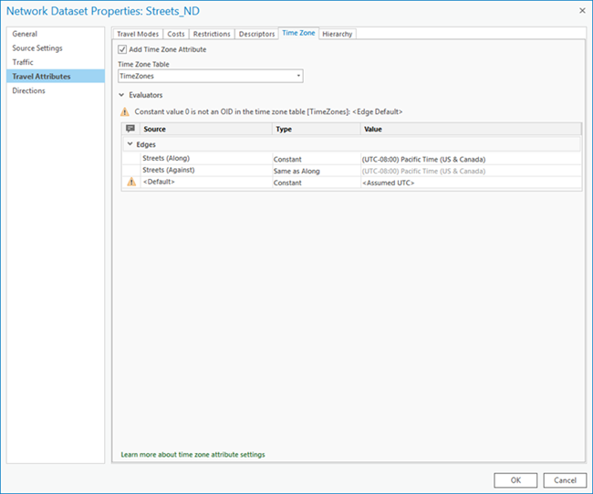

The time zone attribute is configured in the Network Dataset Properties dialog box on the Time Zone tab of the Travel Attributes page:
Time Zone tab
The following properties can be configured:
  • Add Time Zone Attribute—Check this check box to enable or disable time zone support for the network dataset.
  • Time Zone Table—The drop-down list contains time zone tables that reside in the network dataset's workspace.
  • Evaluators—Each attribute defined in the network must provide values for each source and direction (along and against for edges) participating in the network. An evaluator assigns values for the attribute of each source and travel direction, and a default evaluator for each element is used for those sources and directions that do not have an assigned evaluator for an attribute.

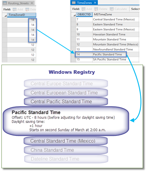

The conceptual diagram below shows a general overview of how this configuration works. A field called TimeZoneID on the edge source feature class indicates the time zone the features are in. The TimeZoneID field value is a foreign key to a time zone table, which resides in the same workspace as the network dataset and stores a list of time zones relevant to the network. The MSTimeZone field in the time zone table is also a foreign key but to an entry in the Windows registry. (It's more common to see integer values as identifiers and foreign keys; however, the registry uses text to identify time zones.) The registry provides information to Network Analyst about the UTC offset and any date ranges for daylight saving time.
Conceptual overview of time zones in the network dataset
Streets with a TimeZoneID field value of 14 are highlighted and related to the Pacific Standard Time record in the time zone table. The MSTimeZone value then relates the streets to the Pacific Standard Time key in the registry. These relationships allow Network Analyst to determine that these streets have a UTC offset of -8 hours from November to March and an offset of -7 from March to November.

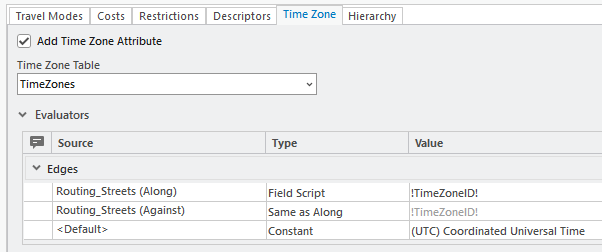

  10. In the Evaluators section, set the Type column to use a Field Script evaluator for the Along direction of the edge sources in the network. Leave the Against direction of the edge sources set to Same as Along.
  11. In the Value column of the Evaluators section for the rows you set to Field Script in the previous step, set the value to the name of the field in the edge source that indicates the time zone of the feature. For example, if the source feature class uses a field called TimeZoneID to refer to the correct row in the time zone table, configure the evaluator to use this field by setting the value to !TimeZoneID!.
    Learn more about assigning an evaluator
    Learn more about evaluators
    Screenshot of time zone attribute configuration using a field script evaluator
    The time zone attribute is configured for this network dataset using a time zone table called TimeZones and a field script evaluator that references a field called TimeZoneID in the Routing_Streets edge source.

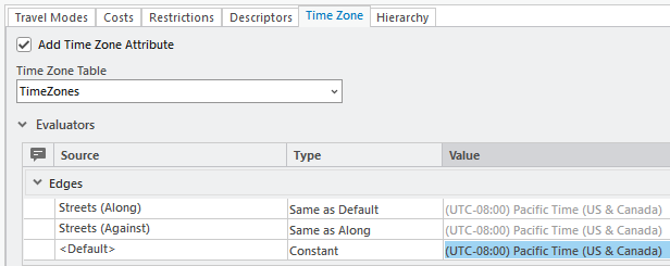

  8. In the Evaluators section, confirm that the row labeled <Default> in the Source column is configured with a Constant evaluator in the Type column and that the Value column shows the display name of the desired time zone for the network dataset. Leave the Along direction of the edge sources in the network set to Same as Default and the Against direction of the edge sources set to Same as Along.
    Because the time zone table has only one row, the network dataset chooses this row as the default time zone automatically.
    Screenshot of time zone attribute configuration using a constant evaluator
    The time zone attribute is configured for this network dataset using a time zone table called TimeZones and a constant evaluator that is hard-coded to a specific time zone. The edge source uses the default edge evaluator because all the edges are within the same time zone.
