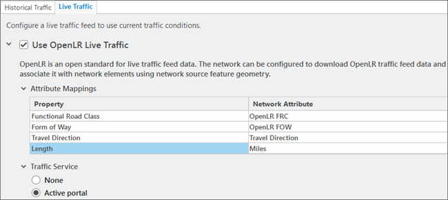

  1. Open the network dataset properties dialog box and click Traffic > Live Traffic.
  2. Check the Use the OpenLR Live Traffic check box to display the OpenLR properties that can be configured on a network dataset that supports live traffic.
  3. Map the OpenLR properties to their corresponding network dataset attributes as in the table below:

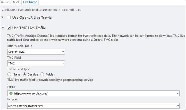

Check the TMC Live Traffic check box to display the TMC properties that can be configured on a network dataset that supports live traffic.
TMC live traffic

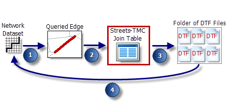

The network dataset reads live traffic speeds from dynamic traffic format (DTF) files and relates the speeds to edges using traffic message channel (TMC) codes. TMC codes are standard unique identifiers that are supported by various organizations, including traffic data providers. The following graphic and the text below illustrate and describe this process:
Generalized live traffic
  1. The network dataset queries an edge for the current travel time. This occurs when a network analysis layer is being solved or when traffic is being drawn on a map.
  2. The identifying source feature information (source feature class, source feature, and from-to and to-from positions) is used to look up one or more TMC values. The lookup is performed with the information that was in the Streets-TMC Table at the time of the last network build. The Streets-TMC Table relates streets to TMC codes.
    Dive in:
    The red box around the Streets-TMC Join Table in the diagram is there to highlight an oversimplification of the diagram. A network dataset doesn't directly reference the join table during the query process; that would be too slow. Instead, the information in the join table is built into the network dataset and referenced internally for faster processing. Consequently, any changes you make to the Streets-TMC table won't be incorporated into the network until it is rebuilt.
  3. The network dataset looks for a DTF file, which is a binary file designed for network datasets, and reads the travel speed information. On the Live Traffic tab, you can specify the folder where the downloaded DTF files reside by clicking the browse button for the Folder option; or use the Service option to use the live traffic feeds from ArcGIS Online or an ArcGIS Enterprise portal that has a proxy to ArcGIS Online.
    Each DTF file is marked with a valid time range and contains TMCs and their corresponding travel speeds for the given time span. The network dataset opens a DTF file only if the time and date for which the edge is being queried is within the DTF file's valid time range. In many cases, multiple DTF files have valid time ranges that are within the queried time. This can occur when live traffic includes traffic predictions of a given depth, for example, for the next 12 hours. If multiple, valid files exist for the queried time, the file that was created immediately before the queried time is opened.
    Dive in:
    Only one DTF file is opened per solve. That is, if multiple, valid files exist, only one is used throughout the duration of that solve process. Whenever the solver queries an edge for a time and date outside the file's time range, it attempts to retrieve the travel time from historical traffic tables instead.
  4. Once the DTF file is opened, the TMC and its associated travel speeds are combined with the length of the queried edge to determine the actual travel time.
    If a valid TMC value or DTF file can't be found, the network dataset falls back to historical traffic to retrieve the travel time. If historical travel times don't exist, it falls back to either a weekend- or weekday-specific network cost attribute, depending on the day of the week for which the edge is being queried. This fallback sequence is set out in the edge traffic evaluators of the traffic-based cost attribute.

      • The portal is not licensed to use live traffic.
      • The ArcGIS Enterprise portal's traffic data service has not been set up to come from ArcGIS Online. You can set up traffic data service for your ArcGIS Enterprise portal using the Configure Traffic Data Service dialog box.
    Once the authorization portal has been set up, the network dataset will store the portal URL.
  • Folder—Choose this option to identify the folder where DTF files are downloaded. The path to the folder can be a local file system path or a Universal Naming Convention (UNC) path.
Modify TMC live traffic
Follow the steps below to modify a network's live traffic settings:
  1. Open the Network Dataset Properties dialog box.
    Learn how to open the Network Dataset Properties dialog box
  2. Click Traffic.
    Two tabs, Historical Traffic and Live Traffic, appear. However, if the network dataset you're using was not configured to support traffic at the time it was created, these tabs will be unavailable.
  3. Click the Live Traffic tab and check the Use TMC Live Traffic check box.
  4. From the Streets-TMC Table drop-down list, choose the Streets-TMC table.
    If your geodatabase does not have a valid Streets-TMC table candidate, the drop-down list will be empty.
    DTF files created from traffic feeds store travel-speed information by TMC code. The Streets-TMC table relates TMC codes to street segments or subsections of street segments so that travel speeds can be linked ultimately to network edges. The Streets-TMC table is often included with network data acquired from a data vendor.
    Learn more about the schema and attributes of a Streets-TMC table
  5. From the TMC drop-down list, choose the field in the Streets-TMC table that contains TMC codes.
  6. Depending on the source you want to use for live traffic feeds, choose from the following options: Service or Folder.
    The path to the folder can be a local file system path or a UNC path.

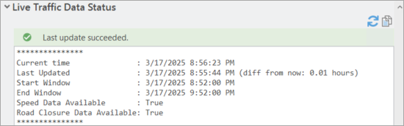

Live traffic data status
Verify whether the live traffic data configuration is successful and the traffic data is updated by following the steps below:
  2. Based on how the network dataset is configured, you should see one of the following:
    1. In the Live Traffic Data Status section, if the network dataset is configured with OpenLR live traffic, you should see Last update succeeded.
      Network dataset configured with open LR live traffic
    2. If the network dataset is configured with TMC live traffic, you should see Live Traffic Source: TMC.
      Network dataset configured with TMC live traffic
  3. Click the Refersh live traffic data status button to get the latest status for live traffic data.
    Note:
    Refresh does not update the traffic data but only updates the status.
