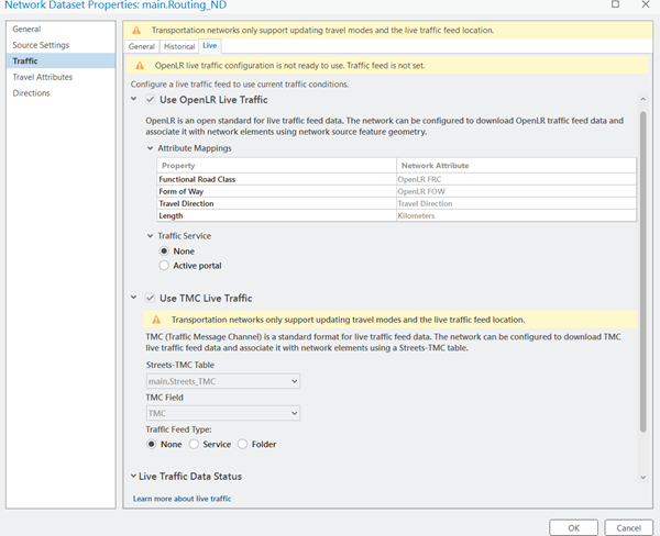

  4. On the Network Dataset Properties dialog box, click Traffic, and click the Live Traffic tab.
    Network Dataset Properties dialog box for main.Routing_ND
    Note:
    OpenLR Live Traffic is supported in 2024 ArcGIS StreetMap Premium releases and later.
    For TMC Live Traffic, skip to step 6.
  5. To use OpenLR Live Traffic, complete the following substeps:
    1. Under Use OpenLR Live Traffic > Traffic Service, click Active portal.
    2. If a warning message appears, click OK to close the Network Dataset Properties dialog box. Then add the TrafficTools toolbox to the Catalog Pane and run the BuildOpenLRCache tool on the StreetMap Premium network dataset before proceeding.
      Network Dataset Properties dialog box for main.Routing_ND with warning message
      The OpenLR Cache table is empty. Run the BuildOpenLRCache tool found in C:\Program Files\ArcGIS\Pro\Resources\NetworkAnalyst\TrafficTools.abtx.
      After the BuildOpenLRCache tool completes successfully and the Network Dataset Properties dialog box is reopened, Live Traffic Data Status indicates Last update succeeded. Otherwise, it will indicate Live Traffic Disabled.
      Network Dataset Properties dialog box for Live Traffic Data Status Live Traffic Disabled
  6. To use TMC Live Traffic, complete the following substeps:
    1. Under Use TMC Live Traffic > Traffic Feed Type, click the Service option. Next, select your region of interest—for example, NorthAmericaTrafficFeed—to dismiss the error message: TMC live traffic feed service. A region is not selected.
      If you signed in successfully to ArcGIS Online, under Portal, you will see a green check mark next to the ArcGIS Online World Traffic Service Web Address. Otherwise, a red exclamation point indicates that live traffic is not available through this portal. In the Portal drop-down list, click https://www.arcgis.com.
      Network Dataset Properties dialog box for main.Routing_ND showing Use TMC Live Traffic settings
