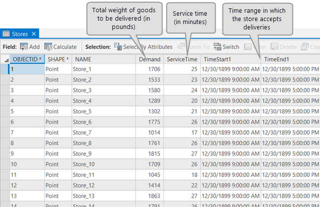

You will add the grocery store locations to the Orders network analysis class. You can think of orders as orders to be filled, since each grocery store has requested goods to be delivered to it from the distribution center. Members of the Orders class will eventually become stops along the vehicles' routes.
The grocery store locations are already added as a feature layer, Stores, in the map document. The attributes of the Stores layer contain information about the total weight of goods (in pounds) required at each store, the time window during which the delivery must be made, and the service time (in minutes) incurred while visiting a store. The service time is the time required to unload the goods.
Attribute table of Stores feature layer containing information about the total weight of goods to be delivered, service time, and the time windows when the store accepts deliveries
The table shows the date values of 12/30/1899. This is the date value used to indicate that only a time is being specified. When all time fields have this date associated with its time values, the solver will use the default date to determine which date to use for the solve. In this case, you will solve for a generic Monday and that will be used in each time field.
Learn more about time windows and how to specify dates

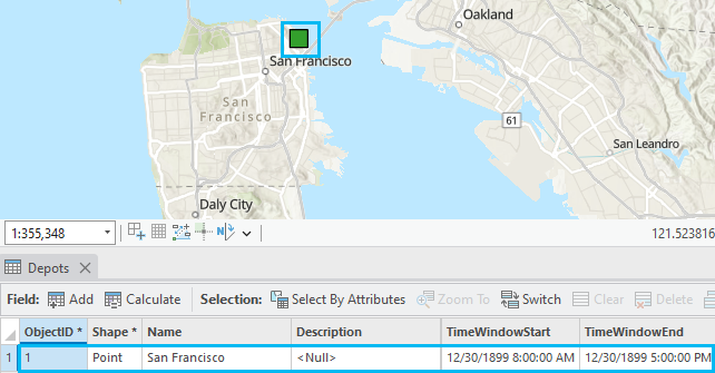

Add depots
The goods are delivered from a single distribution center whose location is shown in the DistributionCenter feature layer that was previously added to the map. The distribution center operates between 8:00 a.m. and 5:00 p.m. You will add this point feature to the Depots network analysis class.
  1. On the VRP Layer tab, in the Input Data group, click Import Depots .
    The Add Locations window appears.
  2. Make sure Input Network Analysis Layer is set to Vehicle Routing Problem and Sub Layer is set to Depots.
  3. Click the drop-down arrow for Input Locations and choose DistributionCenter.
  4. Under Field Mappings, choose Name from Property and make sure NAME is automatically mapped in the Field Name parameter.
  5. Under Field Mappings, choose TimeWindowStart from Property and type 8AM in the Default Value parameter.
  6. Under Field Mappings, choose TimeWindowEnd from Property and type 5PM in the Default Value parameter.
  7. Leave the default settings for the rest of the parameters, and click OK.
One distribution center is listed in the Depots attribute table and displayed as a depot on the map.

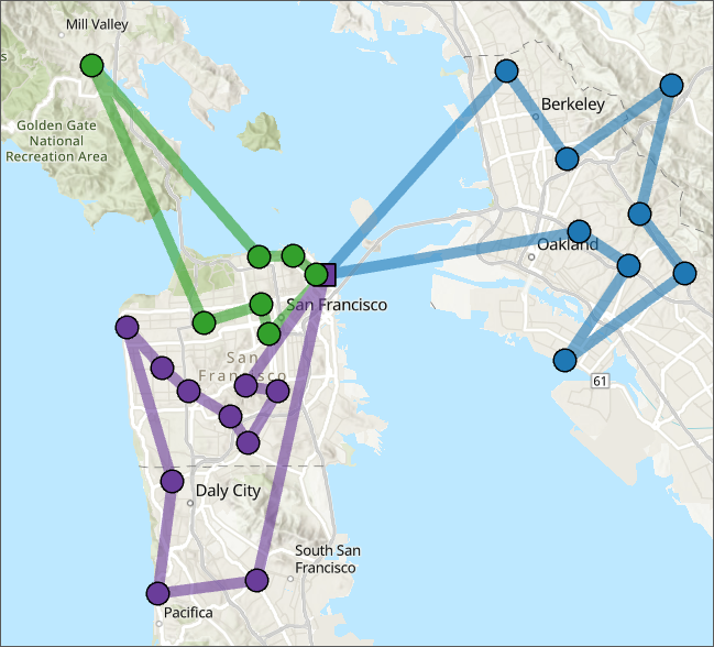

Run the analysis
Run the VRP analysis to determine the best route assignment and order sequence.
  1. On the VRP Layer tab, click Run .
    The VRP solver calculates the three routes required to service the orders and draws lines connecting the orders. Each route begins and ends at the distribution center and serves a set of orders along the way.
    VRP solution with three routes servicing a set of orders

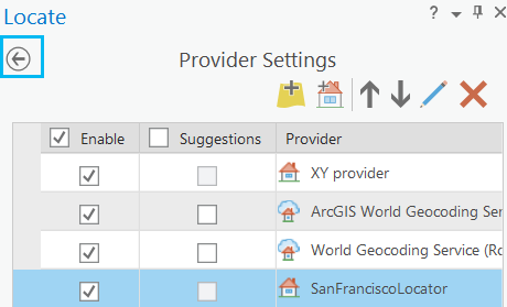

  2. Click the Options drop-down arrow next to the search box and select Provider Settings.
    Provider Settings option
  3. Click the Add Locator to Project button .
    The Select Existing Locator dialog box appears.
  4. Browse to the location of the tutorial data and select SanFranciscoLocator.loc.
  5. Click OK on the Select Existing Locator dialog box.
    SanFranciscoLocator.loc is added to the Provider Settings pane.
  6. Click the Back to Locate Pane button.

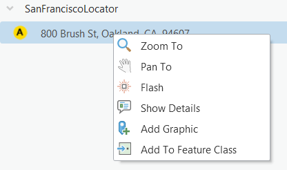

  7. In the Search box, type 800 Brush St. followed by a space. When the suggestions list appears, select 800 Brush St, Oakland, California, 94607 from the list of suggestions under the SanFranciscoLocator heading.
    You may see many suggestions from various locators included in your project.

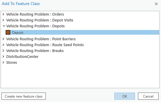

  8. From the list of candidates in the pane, right-click 800 Brush St, Oakland, California, 94607 under the SanFranciscoLocator and select Add To Feature Class from the context menu.
    Context menu with Add To Feature Class
    Note:
    Using World Geocoding Service as the locator uses credits.
  9. From the Add To Feature Class dialog box, expand Vehicle Routing Problem : Depots and select Depots.
  10. Click OK.

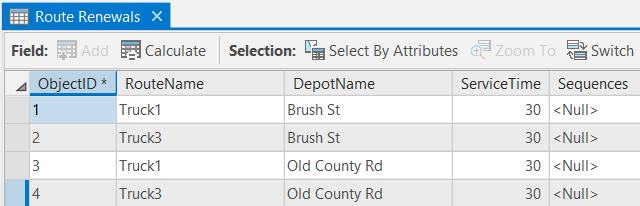

    The next set of steps is to add the route renewal information. Since both trucks are allowed to renew their loads at the Brush St and Old County Rd locations, you will associate each truck with the two renewal locations. The VRP solver calculates the best renewal location for the trucks, if and when they need to reload.
  18. In the Contents pane, right-click the Route Renewals subtable, and click Open.
    The table is empty.
  19. Click the row Click to add new row.
  20. Add the following information in the attribute table:
    RouteName
    DepotName
    ServiceTime
    Truck1
    Brush St
    30
    Truck3
    Brush St
    30
    Truck1
    Old County Rd
    30
    Truck3
    Old County Rd
    30
    Make sure the spelling matches what was used in the Depots and Routes tables Name fields. The attribute table should resemble the image below:
    Route renewals attribute table
  21. On the Edit tab, in the Manage Edits group, click the Save button .
  22. Click Yes on the Save Edits dialog box.
  23. Close the Route Renewals attribute table.

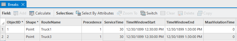

Since the drivers must work longer, they require one half-hour break during their work shift. In this step, you will specify the breaks for each route.
  1. On the VRP Layer tab, in the Input Data group, click the drop-down arrow for Import Breaks and select Add Breaks.
    The Add Fleet Routing Breaks window appears.
  2. Make sure the Input Vehicle Routing Problem Layer parameter is set to Vehicle Routing Problem.
  3. Leave the Target Route Name blank.
    This indicates that the breaks you set up apply to all routes, and entries will be made for each route currently in the Routes attribute table.
  4. Ensure Break Type is set to Time Window Break.
  5. Check the Is Paid box.
    The drivers will be paid during this time, so the cost associated with the time spent on break will be included in the total cost of the route.
  6. Set Break Duration to 30.
    The drivers are given a 30-minute lunch break.
  7. Set Time Window Start to 12:30 PM.
  8. Set Time Window End to 1:30 PM.
  9. Set Maximum Violation Time to 0.
    The breaks must start between 12:30 p.m. and 1:30 p.m. The zero value indicates that the break can't start after 1:30 p.m.
  10. Leave the default settings for the rest of the parameters, and click OK.
The Breaks attribute table now shows two entries, a paid lunch break between 12:30 p.m. and 1:30 p.m. for each of the routes (Truck1 and Truck3).
Breaks added for Truck1 and Truck3
Run the analysis
Complete the following steps to run the analysis:

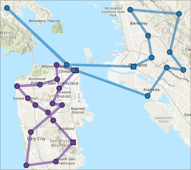

  1. On the VRP Layer tab, click the Run button .
    The VRP solver calculates the two routes that can be used to service the orders and draws straight lines connecting the orders. Each route begins and ends at the distribution center, serves a set of orders along the way, visits a renewal location to load the truck again, continues to service the remaining orders, and returns to the distribution center.
    The Depot Visits attribute table can be examined to see information about the quantity loaded at the beginning of the day and when visiting the renewal locations. It will also show the expected arrival times at these locations.
    VRP solution with two routes servicing a set of orders
