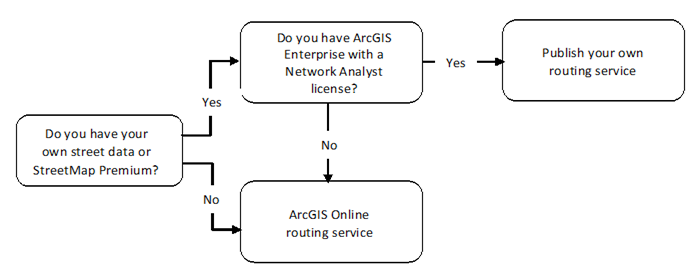

Once you've decided to use routing services, you must decide whether to use the ArcGIS Online routing services or to publish your own routing services with ArcGIS Enterprise.
When to use ArcGIS Online routing services versus publishing your own routing services
The biggest factor in the decision is whether you have access to streets data for your area of interest. If you have good data of the street centerlines, you can use it to create a network dataset and publish routing services. If you do not have good street centerline data and cannot get access to any, the ArcGIS Online routing services may be a better choice.
You can create a network dataset from basic street centerlines. However, the more detailed the data, the better the network dataset and the more accurate the routing. When deciding whether to publish your own routing services or to use those from ArcGIS Online, consider whether you have streets data and what quality that data is.
ArcGIS StreetMap Premium is a detailed dataset with global coverage. For many regions of the world, it has detailed streets down to the local level. Many regions also have historical traffic data. It also comes preconfigured with travel modes, costs, and restrictions. ArcGIS StreetMap Premium datasets include a network dataset that can be used to publish routing services to ArcGIS Enterprise. If you do not have access to your own streets data or are not satisfied with the quality of your data, you may want to consider purchasing ArcGIS StreetMap Premium.

Publishing your own routing services using ArcGIS Enterprise has a few requirements in addition to the data. You will need an ArcGIS Server site with the ArcGIS Network Analyst extension enabled. Federating your ArcGIS Server site to an enterprise portal can help manage and consume the routing services, but it is not necessary for publishing them. However, for best integration across the ArcGIS platform, you should consider federating the ArcGIS Server site that hosts your routing services with an enterprise portal.
