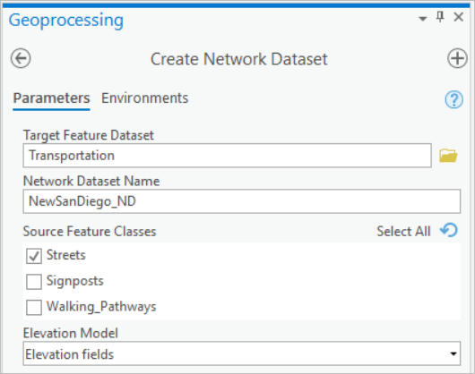

  1. On the Analysis tab, in the Geoprocessing group, click Tools to open the Geoprocessing pane.
  2. Click in the search bar in the Geoprocessing pane and type Create Network Dataset.
  3. Click the first result to open the Create Network Dataset geoprocessing tool.
  4. For the Target Feature Dataset parameter, click the Browse button .
  5. Browse to SanDiego.gdb > Transportation, and click OK.
    The Transportation feature dataset is populated in the Target Feature Dataset parameter.
  6. Type NewSanDiego_ND in the Network Dataset Name parameter.
  7. For the Source Feature Classes parameter, check only the box for Streets.
    Only the Streets feature class will be included as part of the network dataset and not the Walking_Pathways or Signposts feature classes. You’ll add more features and functionality to the network dataset later in the tutorial.
  8. Leave the default value Elevation_Fields for the Elevation Model parameter.
    Learn more about vertical connectivity and the elevation model
  9. Click Run at the bottom of the pane.
    Create Network Dataset geoprocessing tool dialog box
    The new network dataset named NewSanDiego_ND is added to the map.

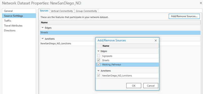

  3. Click the Add/Remove Sources button in the upper right corner of the dialog box.
    One edge source and one junction source are already present. The junction source is the default junction feature class that is created and managed by the network dataset.
    The Add/Remove Sources dialog box appears.
  4. On the Add/Remove Sources dialog box, check the box next to Walking_Pathways and click OK.
    Adding sources through the Add/Remove Sources dialog box
    Other polyline and point feature classes that are in the feature dataset are also listed on the Add/Remove Sources dialog box. A network dataset can have many edge and junction sources that can play different roles. For now, you will only check Walking_Pathways.
    Walking_Pathways appears as a network dataset source.

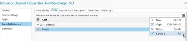

    The Create Network Dataset tool automatically creates one cost attribute, Length, which is based on the geometry field from the network sources.
    While length is an accurate description of what the cost attribute represents, it’s not very clear. Also, the unit of the default distance cost is based on the spatial reference of the source feature classes. In this case, the unit is meters, but you need the units to be in miles. The first modification you’ll make with costs is to rename the default distance attribute to miles; be sure that the evaluators are set properly for all edge sources, and apply an expression to convert meters to miles.
  3. Click the Length attribute in the Distance section of the cost.
  4. Click the Menu button and choose Rename.
    Rename a cost attribute.
  5. Type Miles in the Name text box in the Properties section, and press Enter to accept the name change.
  6. Change the Units value to Miles.

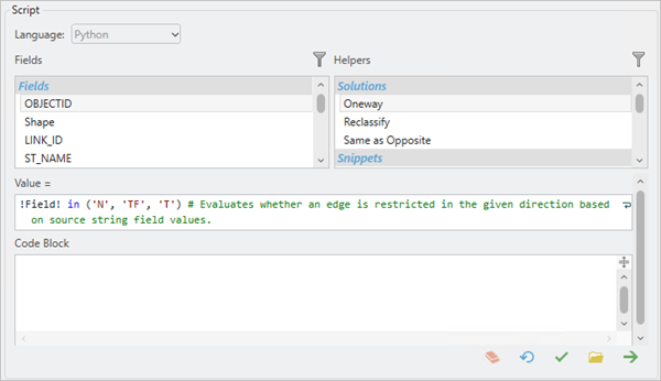

  8. Double-click the Value column of Walking_Pathways (Along) to make the Field Script Settings button available, and click the Field Script Settings button .
    The evaluator settings dialog box appears.
  9. In the Fields selector, double-click Shape to insert !Shape! in the Value box and click OK.

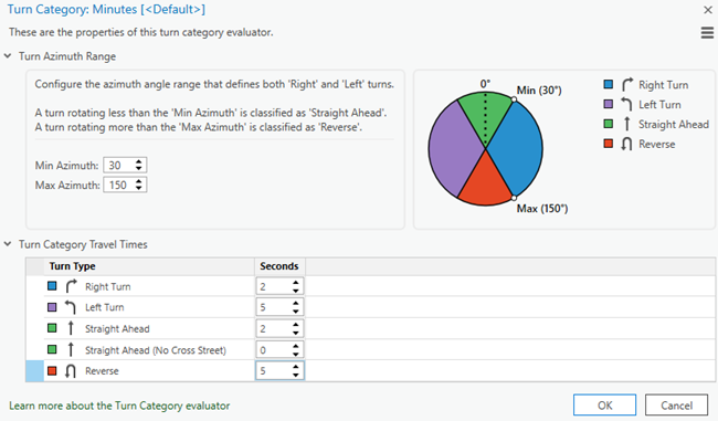

  18. Still in the Evaluators section, in the Turns group, change the Type value of the <Default> row to Turn Category.
  19. Double-click the Value column of <Default> to make the Turn Category Settings button available, and click the Turn Category Settings button.
    The Turn Category Evaluator dialog box appears.
    Learn more about the Turn Category Evaluator
  20. Change the seconds for Left Turn and Reverse Turn to 5.
    Changing the left and reverse turns to have a 5-second delay in the Turn Category Evaluator
    Any analysis using the Minutes cost attribute will add a 5-second delay when a left turn or a reverse turn is encountered.
  21. Click OK to accept the changes and close the Turn Category Evaluator dialog box.
    Note:
    There is a warning on the Minutes cost that the Turn Category Evaluator cannot use road class to distinguish turns because there is no hierarchy attribute. This warning can be ignored. You will address it later in the tutorial when a hierarchy attribute is added.
  22. Click OK on the Network Dataset Properties dialog box to commit the changes made and close the dialog box.

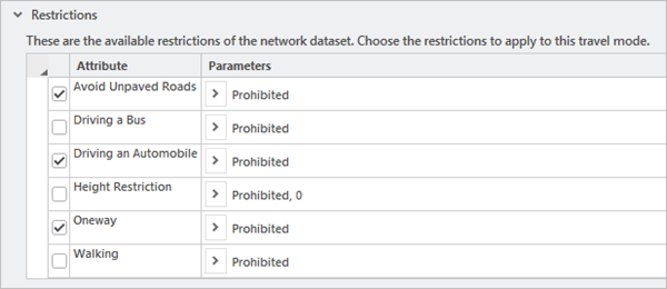

First, you'll create basic restrictions for modeling driving an automobile, driving a bus, and walking.
  1. In the Catalog pane, right-click the NewSanDiego_ND network dataset , and choose Properties to open the Network Dataset Properties dialog box.
  2. Click the Travel Attributes page and click the Restrictions tab.
  3. Click the Menu button in the upper right corner of the Restrictions tab and choose New.
  4. Type Driving an Automobile for the name of the new restriction.
  5. Leave Usage Type set to Prohibited.
  6. In the Evaluators section, in the Edges group, for the Streets (Along) row, change the Type value from Same As Default to Field Script.
    An X icon appears next to the Streets (Along) and Streets (Against) rows, but it will disappear after you choose a field on which to base the evaluator.
  7. Double-click in the Prohibited column of the Streets (Along) row to make the Field Script Settings button available, and click the Field Script Settings button.
  8. Type !AR_AUTO!=="N" in the Value box and click OK.
    This field denotes whether a car can legally travel on the road. A value of Y indicates that automobiles can travel on that road, while a value of N indicates that automobiles cannot travel on that road.
    Restrictions are always a Boolean type. When you define field script, element script, or function for a restriction, you tell the restriction which values returned by the expression, script, or function count as True, which will affect that edge. Any other value will be interpreted as False, leaving the edge unaffected. In this case, when the restriction affects the edge, it will prohibit it from being traversed.
  9. Leave Streets (Against) set to Same as Along.
  10. For Walking_Pathways (Along), change Type to Constant and Prohibited to True.
  11. Leave Walking_Pathways (Against) set to Same as Along.
    Walking pathways should never allow motorized vehicles on them, so you can set a constant value to make them always restricted when this restriction is active.

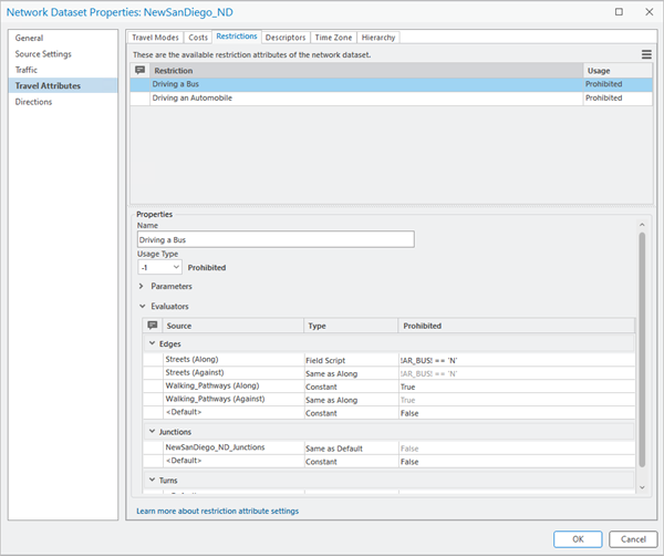

  12. Add a new restriction to prohibit buses from traversing certain roads by repeating steps 4 through 11, naming the restriction Driving a Bus, and using the AR_BUS field.
    Restriction page in the Network Dataset Properties window showing the Driving a Bus restriction
  13. Add a new restriction named Walking.
  14. For Streets (Along), change the evaluator Type to Field Script.
  15. Double-click in the Prohibited column of the Streets (Along) row to make the Field Script Settings button available, and click the Field Script Settings button .
  16. On the evaluator settings dialog box, in the Value box, type !AR_PEDEST! == "N".
    This restricts roads that are interstates or other high-traffic roads that are off-limits to pedestrians when the Walking restriction is active.
  17. Leave the default evaluator settings for the Walking_Pathways edge.

    Next, you'll add a restriction for one-way streets.
  22. Add a new restriction named Oneway.
  23. For Streets (Along), change the evaluator Type to Field Script.
  24. Double-click in the Prohibited column of Streets (Along) to make the Field Script Settings button available, and click the Field Script Settings button .
    One-way streets are typically restricted in one direction of travel on a street. In this case, you want different values for different directions of travel along an edge. You’ll set up similar, but slightly different, field expressions for each direction of travel on Streets.
  25. In the Helpers selector, double-click Oneway.
    This will insert a Python expression that will look for values of N, TF, or T and restrict that edge if it has one of those values. It is written as an expression that is not case sensitive.
    The TF and T values typically stand for To-From and To, respectively. These values indicate which direction of travel is restricted on the edge. According to the expression, travel in the To-From, or against, direction is prohibited, while travel in the From-To, or along, direction is allowed. The N will be used in the expressions for both the Along and Against directions. Any line that has an N value will be prohibited from being used in a route.
    Field Script: Oneway dialog box showing what the script for the Oneway restriction should be for the Along direction
  26. Replace the text !Field! in the Value box with the text !DIR_TRAVEL!
    This will ensure the expression works with the field name DIR_TRAVEL.
  27. Click OK on the evaluator settings dialog box to accept the changes.
  28. For Streets (Against), change the evaluator Type to Field Script.
  29. Open the evaluator settings dialog box for the Streets (Against) row.
  30. In the Helpers selector, double-click Oneway.
    This expression is the same as the last one, except that instead of TF and T, it uses FT and F. This expression will restrict the opposite set of streets to the other expression, which is what is needed for the other half of the one-way restriction.
  31. Replace the text !Field! in the Value box with the text !DIR_TRAVEL!
  32. Click OK on the evaluator settings dialog box to accept the changes.

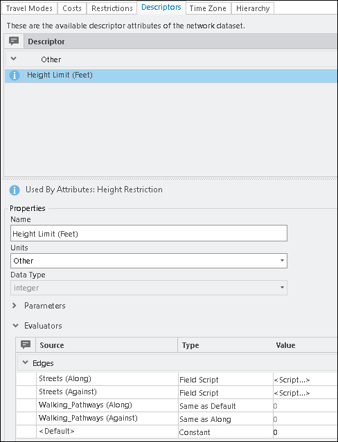

    You'll want to add a new parameterized restriction to model a vehicle height limit on some streets. You'll start by creating a descriptor that will pull the vehicle height from the Streets feature class.
  33. Click the Descriptors tab.
  34. Click the Menu button and click New.
  35. Type Height Limit (Feet) for the name.
  36. For the Streets (Along) row, change the evaluator type to Field Script.
  37. Open the evaluator settings dialog box for the Streets (Along) row.
  38. Type MetersToFeet(!FT_HeightLimit_Meters!) in the Result box and the following expression in the Code Block box:
    def MetersToFeet(value):
     if value is None:
      return value
     return value / 0.3048
    This expression takes the value from the FT_HeightLimit_Meters field and converts it from meters to feet.
  39. For the Streets (Against) row, change the evaluator type to Field Script.
  40. Open the evaluator settings dialog box for the Streets (Against) row.
  41. Type MetersToFeet(!TF_HeightLimit_Meters!) in the Result box and the following expression in the Code Block box:
     if value is None:
      return value
  42. Click OK to accept the expression.
    Descriptors tab with the completed

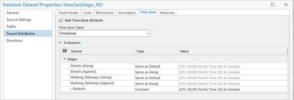

Add a time zone attribute
Time zone attributes allow a network dataset to manage time zones so that time-of-day values are clear and traffic-enabled network datasets retrieve the travel times for the right time of day. Some types of network analysis, such as Last Mile Delivery analysis, require a time zone attribute. You'll set up a time zone attribute so that you can run all analysis types using this network dataset.
Learn more about time zone attributes
  2. Click the Travel Attributes page and click the Time Zone tab.
  3. Check the Add Time Zone Attribute check box.
  4. From the Time Zone Table drop-down list, ensure the TimeZones table is selected.
  5. Ensure the values in the Evaluators grid are filled in already, with the <Default> evaluator's Type set to Constant and the Value set to (UTC-08:00) Pacific Time (US & Canada) and the other evaluators using the default value.
    Evaluators grid
    The TimeZones table has one entry, Pacific Standard Time. This is a value that corresponds to one in the Windows registry, which is how the network dataset knows which time zone to use. Because there is only one entry, the network dataset fills in that value as the default, and only, value to use. If your network dataset spans multiple time zones, you can set that up using a field evaluator. The steps for that process, and more information on the time zone attribute, are described in the Time zone attribute documentation.
  6. Click OK on the Network Dataset Properties dialog box to commit the changes made and close the dialog box.

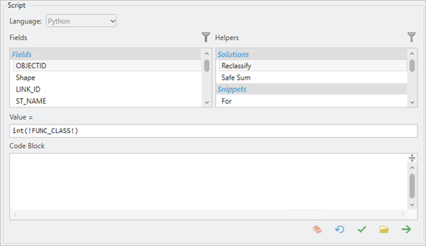

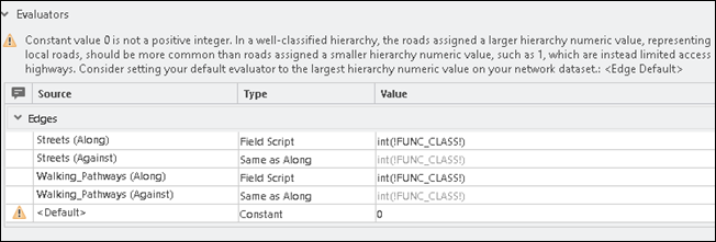

  6. For the Streets (Along) row, change the evaluator type to Field Script, and open the evaluator settings dialog box.
  7. In the Result box, type the following expression:
    int(!FUNC_CLASS!)
    The hierarchy attribute requires an integer input greater than 0. Because the FUNC_CLASS field is a text field, you need to use a method to convert the field value to an integer.
    Convert the field value to an integer.
  8. Click OK to accept the expression.
  9. Repeat steps 6 through 8 for the Walking_Pathways (Along) row.
    Convert the field value to an integer for Walking_Pathways (Along).

  9. In the Restrictions section, check the boxes for the Avoid Unpaved Roads, Driving an Automobile, and Oneway restrictions, as shown in the following image:
    Avoid Unpaved Roads, Driving an Automobile, and Oneway restrictions checked in the Automobile Time travel mode
    When setting the travel modes, only check one of the transportation methods (Driving an Automobile, Driving a Bus, or Walking). These restrictions indicate where it is legal for each mode of transportation to traverse. Checking more than one will improperly restrict or allow some edges.
    You are not checking the Height Restriction attribute because cars do not typically have a problem with height restrictions on roads.

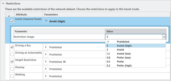

  19. In the Restriction section, click Avoid Unpaved Roads.
  20. Change the value for Restriction Usage parameter to Avoid (high).
    Changing the value for the Avoid Unpaved Roads restriction from Avoid to Avoid High
    The tour buses do not handle unpaved roads well. Setting the Restriction Usage parameter for this travel mode to Avoid (High) will ensure that unpaved roads will only be used if necessary.
  21. Ensure that the check box for Avoid Unpaved Roads is checked.

  24. Click Height Restriction.
  25. Change the value of the Vehicle Height (Feet) parameter to 11.
    Whatever value is populated here will be the default value used for assessing vehicle height against the height limit on the road. Eleven feet is a good default value for the vehicle height because most single-level tour buses average between 10 and 11 feet tall.
  26. Ensure that the check box for Height Restriction is checked and Restriction Usage is set to Prohibited.

  5. Double-click the Value column of <Default> to make the Turn Category Settings button available.
    Notice that the value now says that there are 20 turn categories, rather than the 5 it showed when you set up the Turn Category Evaluator.
  6. Click the Turn Category Settings button to open the Turn Category Evaluator dialog box.
    Updated Turn Category Evaluator with categorized roads
    The Turn Azimuth Range section remains the same; however, there is now a section called Road Classes. This section allows you to change which hierarchy values are counted as primary, secondary, or local roads for the Turn Category Evaluator.
    By default, it will use the ranges defined in the hierarchy attribute. Unless you have a specific reason to change the ranges, leave the default ranges.
    The Turn Category Travel Times section shows more categories of turns now that the roads can be classified by hierarchy.

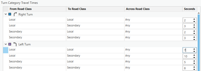

  7. In the Left Turn group, change the Seconds value for Local: Local : Any from 5 to 7.
    The columns indicate the class of the road on which the turn starts; the class of the road on which it ends; and if any road is crossed (such as at a normal intersection), what the class of that road is. For example, if you needed to cross a major street to continue on a local alley, you would need to wait several seconds for traffic to clear. By default, this type of maneuver has a delay of 15 seconds. But if you only needed to cross another small road to continue on the alley, you wouldn’t need to wait as long. This maneuver has a delay of 2 seconds.
  8. Click OK to accept the changes and close the Turn Category Evaluator dialog box.

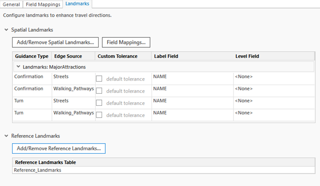

  13. Click the Landmarks tab.
    There are two groups: Spatial Landmarks and Reference Landmarks. Spatial landmarks are feature classes, and reference landmarks are tables. Spatial landmarks rely on a spatial search at the time of the solve to determine when a landmark should be referenced. Reference landmarks have their location on the network built into the row so that only a table search is required to use the landmark in the directions. A spatial search is slower than a regular table search, so reference landmarks perform faster than spatial landmarks.
    Because spatial landmarks use a simple spatial search to determine their location, they are quick to set up. You need a point feature class with at least one text field, which will serve as the label for the landmarks. Other fields may be used to define other characteristics, such as a level, often used in indoor routing, or a custom search tolerance for each point feature.
    Reference landmarks require more work to set up. They need a specific schema and must be manually configured with a network location and other required fields.
    You’ll be setting up both spatial and reference landmarks.
    First, you'll set up the spatial landmarks.

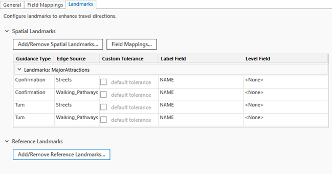

  14. Click the Add/Remove Spatial Landmarks button.
    The Add/Remove Spatial Landmarks dialog box appears, and there are two groups in it. Confirmation guidance landmarks notify the driver that they are on the correct route; for example, “Go by Eastlake Park on your left.” Turn guidance landmarks help the driver maneuver through a junction; for example, “Turn left before the Tall White Cylindrical Building on 1st Ave.”
    Landmark feature classes must be in the same feature dataset as the network dataset. A single landmark feature class can be registered as both confirmation and turn guidance landmarks.
  15. Expand the tree view for MajorAttractions under the Confirmation Guidance group.
    Landmark feature classes are registered as either confirmation guidance or turn guidance landmarks per edge source. In most cases, you’ll want to register a landmark feature class for all edge sources as either confirmation guidance or turn guidance landmarks, or both.
  16. Check the box next to the top-level MajorAttractions feature class in both the Confirmation and Turn Guidance sections.
    The MajorAttractions feature class represents major attractions in the city of San Diego. These attractions may be next to Streets or Walking_Pathways features. They also may be used for turn and confirmation guidance. You’ll register the MajorAttractions feature class for all edge sources for both groups of landmarks.
    Note that once you check the top-level box, all the sublevel check boxes are also checked.
  17. Click OK to accept the registration of the spatial landmarks.
    MajorAttractions feature class registered as turn and confirmation guidance spatial landmarks
    The grid under the Spatial Landmarks header will be filled in with the landmark registrations.
  18. Click the Field Mappings button.
    The Spatial Landmarks Field Mappings dialog box appears.
    By default, the Name field was selected for Label Field for the landmarks, and Level Field was left set to <None>.
  19. Click the drop-down lists Label Field and Level Field and note the choices.
    Spatial Landmarks Field Mappings dialog box with the Label Field drop-down list showing all text fields in the MajorAttractions feature class
    The Label Field drop-down list shows all text fields in the MajorAttractions feature class; the Level Field drop-down list shows all integer fields.
    Making a change on this dialog box sets the field mappings for all guidance types and edge sources.
  20. For now, do not change any of the fields, and click Cancel to close the Spatial Landmarks Field Mappings dialog box.
    Next, you'll set up the reference landmarks.

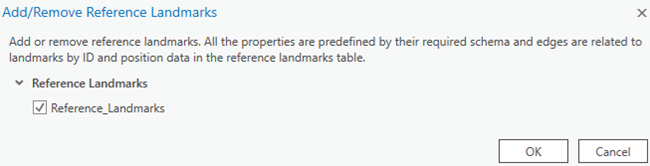

  21. Click the Add/Remove Reference Landmarks button.
    The Add/Remove Reference Landmarks dialog box appears.
  22. Check the box next to Reference_Landmarks.
    The table Reference_Landmarks is registered as a landmark table in Directions.
    Only tables that have the required schema for reference landmarks will appear as candidates on this dialog box.
  23. Click OK to accept the registration of the reference landmarks.
    The completed Landmarks tab should resemble the image below:
    Landmarks tab with registered spatial and reference landmarks
