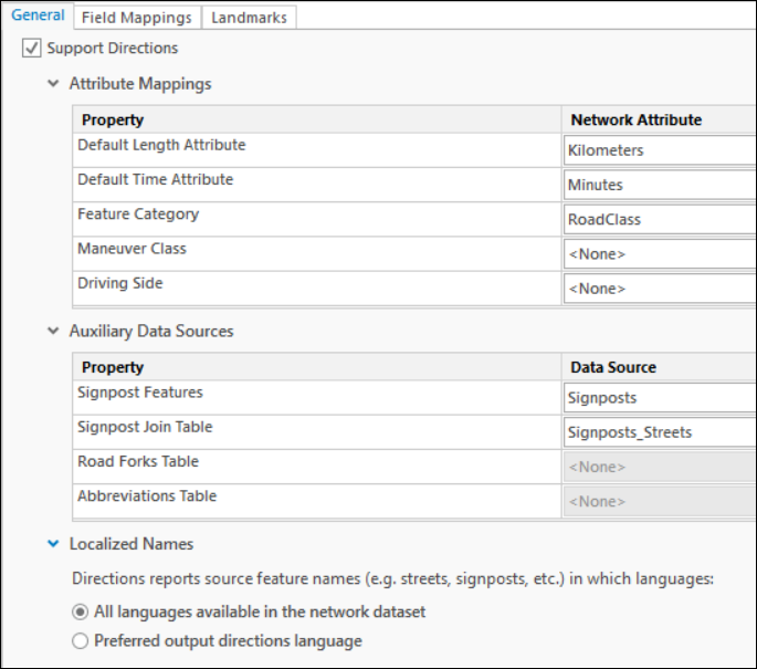

General
The units used to report directions and the fields used to identify streets can be modified on the General tab.
Modify units used to report directions and fields used to identify streets on the General tab
Attribute Mappings
The following options are available under Attribute Mappings:
  • Default Length Attribute—Calculates the length of each segment of the route for which the directions are reported. Any cost attribute can be selected as the length attribute. ArcGIS automatically searches through the network attributes and tries to assign the relevant cost attribute.
  • Default Time Attribute—Calculates the time taken to traverse each segment during the reporting of directions.
  • Feature Category—Provides specific directions for different types of roads and other linear features. It is a descriptor attribute of type integer whose values are as follows:

  • Maneuver Class—Identifies the driving directions to small connecting roads inside of or adjacent to the street intersection. It is a descriptor attribute of type integer whose values are shown in the following table:
    Maneuver class values
    Maneuver class type
    Description
    Default
    Default value assigned to streets outside of street intersections.
    Intersection Internal
    Street segments internal to an intersection of double-digitized roads.
    Maneuver
    Street segments forming a turning slip lane (often found where streets intersect at a sharp angle).
  • Driving Side—Indicates what side of the road vehicles typically drive on in the region. For example, for roads in Canada, vehicles drive on the right; for roads in Australia, vehicles drive on the left. Setting this property allows improved directions output by reporting details that are dependent on what side of the road vehicles drive (for example, traveling clockwise versus counterclockwise through a roundabout), as well as suppressing reporting fork instructions that are considered redundant. The driving side of the street segment is represented as an integer value that falls into the following domain values:
    • 0—Unspecified/Undefined driving side
    • 1—Right driving side
    • 2—Left driving side
Auxiliary data sources
The following are the auxiliary data sources:
  • Signpost Features and Signpost Join Table—Provide the text of the highway signs that a driver would typically see when traveling along the route. This highway sign text usually includes the exit number, name of the road, and the destination where the road leads. This text can be incorporated into the directions text to facilitate navigation—for example, Take ramp and go on US-59 N toward Springfield.
    Learn more about Signpost feature class and Signpost Join Table
  • Road Forks Table—Identifies pairs of edges (by EdgeFCID/FID/FrmPos/ToPos) where you can explicitly place a driving directions instruction that the road forks.
    Learn more about Road Forks table
  • Abbreviations Table—Contains the rules on how to expand directional and street type abbreviations for voice guidance.
    Learn more about Abbreviations Table
