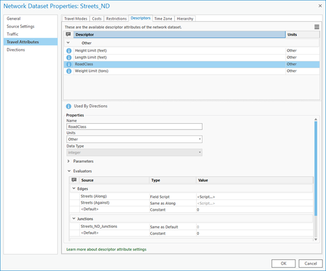

The Descriptors tab displays the descriptor attributes that are available with the network dataset and the properties associated with the selected descriptor.
The Properties section displays how the selected descriptor is configured. It lists the metadata associated with the descriptor attributes and the details on how the parameters and evaluators are configured.
Descriptors are displayed on the Network Dataset Properties, under Travel Attributes.

Create a descriptor attribute
Complete the following steps to create a descriptor attribute:
  1. Access network attributes on the Network Dataset Properties dialog box.
  2. Click the Descriptors tab.
  3. Click the Options button in the upper right corner of the dialog box.
  4. Click the New button from the menu, or press Ctrl+N.
    A new row is added to the Descriptor section.
  5. In the Properties section, type the name for the new descriptor attribute in the Name field.
  6. Choose a unit from the Units drop-down list. If the descriptor attribute is time based, choose any of the available time units. If the descriptor attribute is distance based, choose a distance-based unit. If the descriptor attribute is speed based, choose a speed-based unit. Otherwise, choose Other.
  7. Expand the Parameters section, if necessary, to add a new parameter.
    Learn more about creating a parameter
    Learn more about parameters
  8. In the Evaluators section, assign an evaluator to the source features.
    Learn more about assigning an evaluator
    Learn more about evaluators
  9. Click OK.
    The descriptor attribute is saved to the network dataset.
