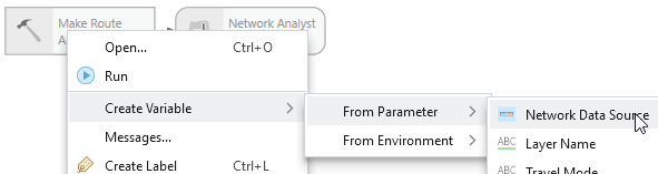

    The Network Data Source input variable may not be present. In that case, right-click the Make Route Analysis Layer tool and choose Create Variable > From Parameter > Network Data Source. The items in the model will still appear gray because the Network Data Source variable has not yet been set to a value, but you can proceed with the tutorial steps.
    Add the network data source parameter as a model variable.

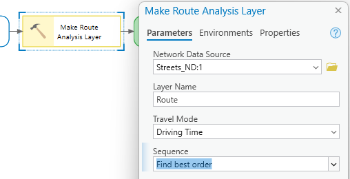

  7. Double-click the Make Route Analysis Layer tool in the model.
    The Make Route Analysis Layer tool dialog box appears so you can edit the parameters.
  8. Change the Sequence parameter to Find best order and click OK to close the tool dialog box.
    The Find best order option allows the order of the route stops to be rearranged to minimize the overall travel time.
    Make Route Analysis Layer tool dialog box with the Sequence parameter set to Find best order

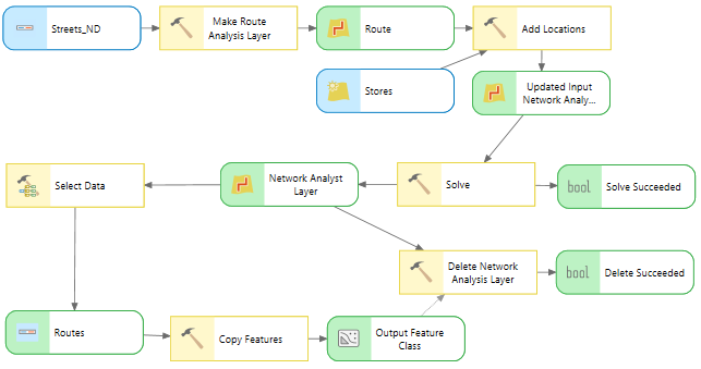

    The model is arranged in a logical order and resembles the example below:
    Add Locations tool in ModelBuilder

  26. Click the Auto Layout button to arrange the model elements.
    Auto layout the model
    Note:
    The layout of the model elements has been modified from the default to make it easier to see in the image.

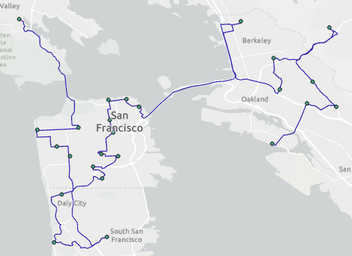

    Once the model has been successfully run, you can optionally visualize the model output, which is a line feature class representing the optimal route visiting the stores.
  31. In the Catalog pane, expand Databases and look for the Routes_CopyFeatures feature class in the project geodatabase.
  32. Add the Routes_CopyFeatures to the current map to visualize the output.
    Output of the route analysis model showing route between the input locations

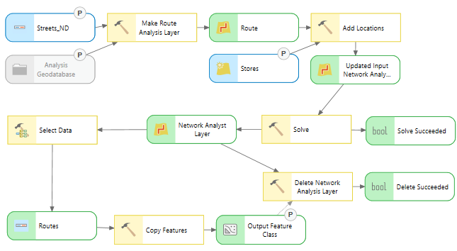

  1. Switch to the model view and right-click Stores. Select Parameter from the context menu that appears.
    The variable is set as a parameter, which is indicated by the letter P next to the variable in the model. The person who runs the model tool will be able to choose the input for the model.
  2. Repeat step 1 for the Streets_ND and Output Feature Class variables in the model.
    Setting Streets_ND as a model parameter allows the person who runs the model tool to choose the network data source to use for the analysis.
    The Output Feature Class is the output of the model where the analysis results are saved. Setting it as a parameter allows the person who runs the model tool to specify their desired output file path. Additionally, the output will be added to the map view and the Contents pane when the tool is run.
  3. Right-click the Make Route Analysis Layer tool in the model and choose Create Variable > From Parameter > Analysis Geodatabase.
    The Analysis Geodatabase parameter is added to the model as a variable. This parameter allows you to set the geodatabase workspace where the route analysis layer's sublayer data will be created. Learn more about the analysis data source of a network analysis layer
  4. Right-click the Analysis Geodatabase model variable and select Parameter from the context menu that appears.
    The variable is set as a parameter, which is indicated by the letter P next to the variable in the model. The person who runs the model tool will be able to choose the analysis geodatabase when running the model tool.
    Model updated with variables set as model parameters

    The Analysis Geodatabase parameter is grayed out because no default value for it has been set yet. You will add a default in the next few steps.
    Note:
