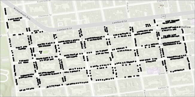

Add the Houses feature class
The resident locations that need to be collected for Monday have already been converted into a feature class with information about how many waste collection bins, recycling bins, and yard waste bins each house has. You can use geocoding to create a feature class from your own address data.
  1. In the Catalog pane, expand Folders > Tutorial > SanFrancisco.gdb > Analysis.
  2. Drag the Houses feature class onto the map.
    The feature class is added to the Contents pane as well as to the map.
  3. In the Contents pane, right-click the Houses feature class and select Zoom To Layer.

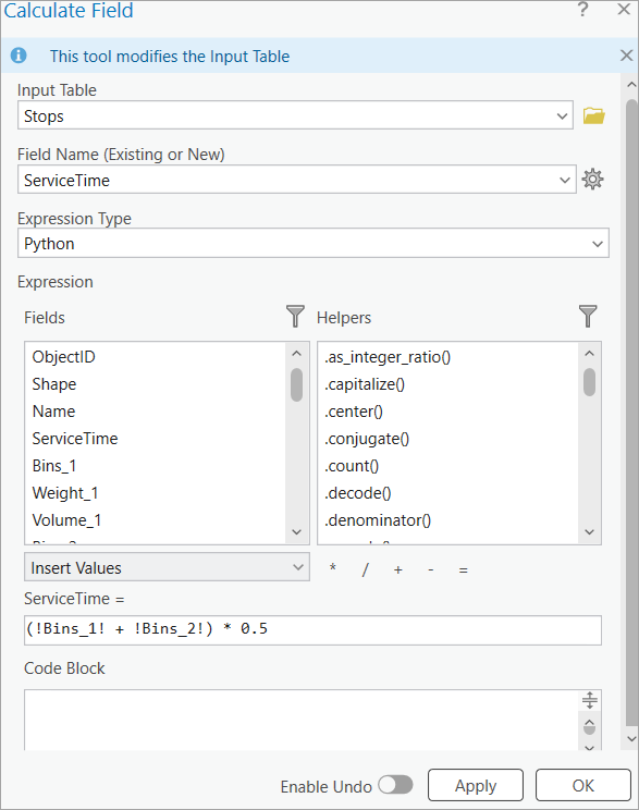

  9. In the Contents pane, right-click the Stops sublayer, and select Attribute Table.
  10. In the attribute table, right-click the ServiceTime field, and select Calculate Field.
    The Calculate Field dialog box appears.
    In steps 11 and 12, you will calculate the service time based on the number of bins to collect, but both the waste and recycling bins need to be accounted for. It takes 30 seconds, or 0.5 minutes, to collect each bin.
  11. Set the ServiceTime value to (!Bins_1! + !Bins_2!) * 0.5.
    The window should resemble the following:
    Calculate service time for each stop.
  12. Click OK.
    The ServiceTime field is now populated with an appropriate value.

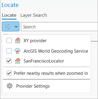

  3. Click the Options drop-down arrow next to the search box.
    Options button in the Locate pane
  4. Uncheck all available locators, except SanFranciscoLocator.

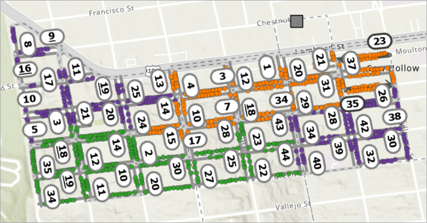

  4. In the Analysis group, click Run.
    The Waste Collection solves. The Stops are assigned to routes, and the symbology updates to creating the route lines and showing assigned stops following the default color scale.
    Stops are assigned to routes.

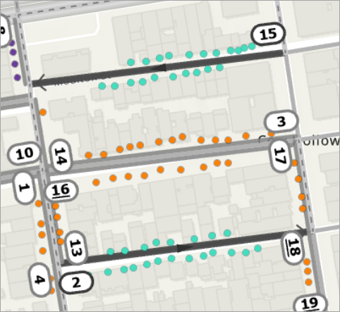

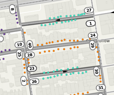

Examine one-way streets
There are two blocks that are one-way streets. With the current setup, these blocks are to be traversed twice, collecting each curbside separately. In some situations, it would instead make sense to collect both curbs at the same time, going down the street just a single time. To do this, you will use the Stops CollectionMode attribute field to indicate that for just these blocks you want to collect both sides together.
Learn more about network dataset symbology

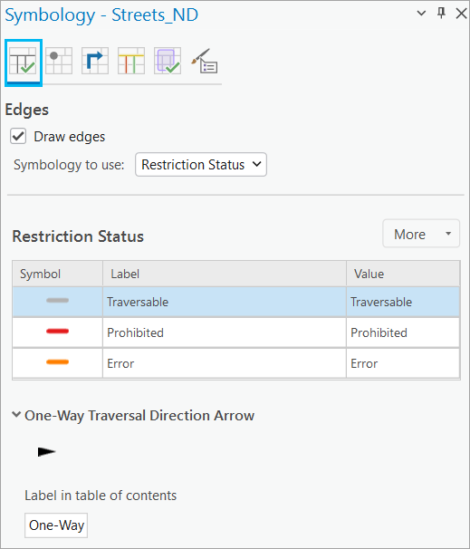

  1. If the Streets_ND network dataset layer is not in the Contents pane, add it again.
  2. Check the layer to make it visible.
  3. Right-click Streets_ND and select Symbology.
  4. Select the Symbolize edge lines of your network dataset layer option.
    Symbolize edge lines.
  5. Check Draw edges and from the Symbology to use drop-down menu, select Restriction Status.
  6. Switch to the Symbolize traffic lines of your network dataset layer option.
  7. Uncheck Draw traffic.
    In the Northeast of our study region, Moulton St shows the one-way arrow, indicating it is a one-way street with direction of travel being from east to west. Similarly, two streets south, Pixley St is a one-way street with the direction of traffic being from west to east. Looking at the sequences of the collection edges in the RouteLines sublayer, you can see that both of these streets are traversed twice, once collecting on the right side of the street and once collecting on the left side of the street.

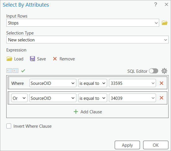

  8. Select all of the stops on both of these two street edges by following the steps below:
    1. Select a stop on one of the street edge and take a note of the SourceOID.
    2. Repeat the same for the other edge.
    3. Open the attribute table for the Stops sublayer and click Select By Attributes .
      The Select By Attributes dialog box appears.
    4. Set a query based on the SourceOID of the two streets noted above such that the stops on both sides of these streets get selected.
      Select stops based on the street SourceOID.
      Stops on both one-way streets get selected.
      Stops on both one-way street edges selected

    Domain value for collection mode
  11. In the Analysis group, click Run to rerun the analysis. Examine how the collection of these streets change.
    Symbology updated to collect both sides

  1. Click the Map tab, and in the Inquiry group, click the Locate button .
    Locate button in the Inquiry group
    The Locate pane appears.
  2. In the search text box, enter the transfer station address, ALANA WAY, BRISBANE, CA, 94005, and press Enter.

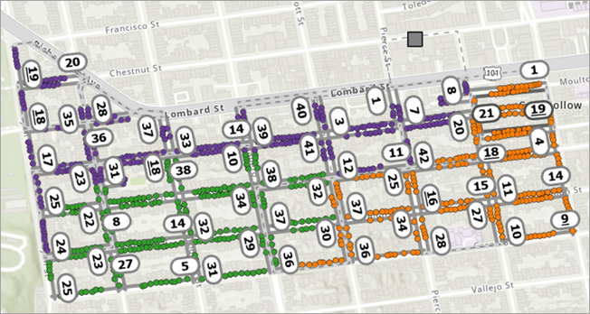

  7. In the Analysis group, click Run.
    The Waste Collection solves. Right-click the Stops sublayer and select Zoom To Layer. The stops are assigned to routes, and the symbology updates to creating the route lines and showing assigned stops following the default color scale.

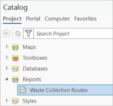

In the Catalog pane, in the Reports section, the copied report file can be found. To customize the report file, you can open the report from here and have the full capabilities of reports. Or select a location on your machine to save the file and run the geoprocessing tool to see the report .pdf file.
Report file generated
