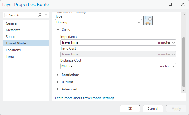

View or change the impedance attribute used for the analysis and check its units
The impedance attribute is the cost attribute being optimized for the analysis. It also determines the units of measurement used to interpret some input fields and settings and reported in some output fields.
Learn more about cost attributes
The Costs section of the Travel Mode property page shows the impedance attribute and its units. The travel mode's time attribute and distance attribute, which are used for fleet routing analysis types, are also shown.
Travel mode property page showing the impedance attribute and units
The travel mode's impedance units are also shown on the network analysis layer's ribbon next to the travel mode for quick reference.

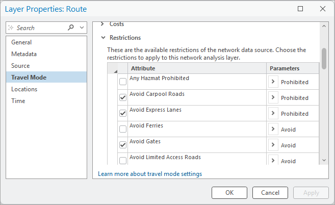

View or change the restrictions applied for the analysis
Restrictions control where travel is forbidden, discouraged, or preferred.
Learn more about restriction attributes
The Restrictions section of the Travel Mode property page shows the list of available restriction attributes. The ones that are checked on are applied for the analysis.
Travel mode property page showing the restrictions used in the analysis

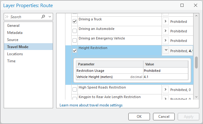

Each restriction attribute has one or more attribute parameters whose value can be adjusted for the analysis. For example, the height restriction for this analysis includes a parameter to adjust the vehicle's height.
Learn more about attribute parameters
Parameters and their values can be viewed and changed by expanding the Parameters area next to each restriction.
Travel mode property page showing the attribute parameter values for the selected restriction

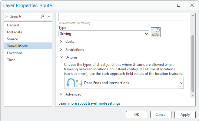

View or change the U-turn policy for the analysis
The U-turn policy controls whether and where a vehicle can make a U-turn.
Learn more about U-turn policies
The U-turns section of the Travel Mode property page shows the travel mode's U-turn policy.
Travel mode property page showing the U-turn policy
