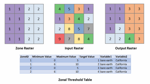

The zone raster, a sample input raster, the output raster, and a zonal threshold table

A table containing at least three fields. It must have a minimum threshold value, maximum threshold value, and target value. The target value is the field that will contain the remapped value.

If you were using the table above as an example, the query would be Variable1 = 'bare earth' AND Variable2 = 'California'.
