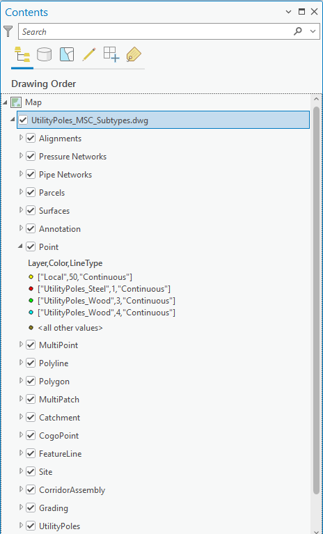

A CAD file added to the map is shown below in the TOC using the default geometric-based feature layer organization and symbolized by CAD entity properties:
CAD file displayed in TOC
