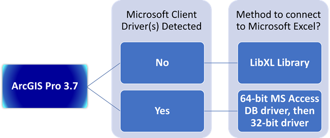

If you already have the Microsoft Access driver installed and can access Excel files from ArcGIS Pro, you can continue using it. This configuration is still the recommended workflow for working with Excel files. When you attempt to access an Excel file from ArcGIS Pro, the software first checks for the presence of Microsoft Access drivers as follows:
  • If a Microsoft Access driver is found, ArcGIS Pro will attempt to use it (prioritizing 64-bit drivers before 32-bit drivers) to access the Excel file. If successful, no further action is needed.
  • If no Microsoft Access driver is found, ArcGIS Pro will automatically use the LibXL library to allow users to access Excel files without installing additional drivers.

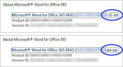

    These instructions apply to any Microsoft Office application, such as Word or Excel.
    Instructions: Click the About Word button.
    About Word button.
    The About Microsoft Word for Office 365 window opens. The top line contains the combined version and build number; at the end, it displays whether it's 32 bit or 64 bit.
    About Microsoft Word window indicates the bit version of the installed Microsoft product

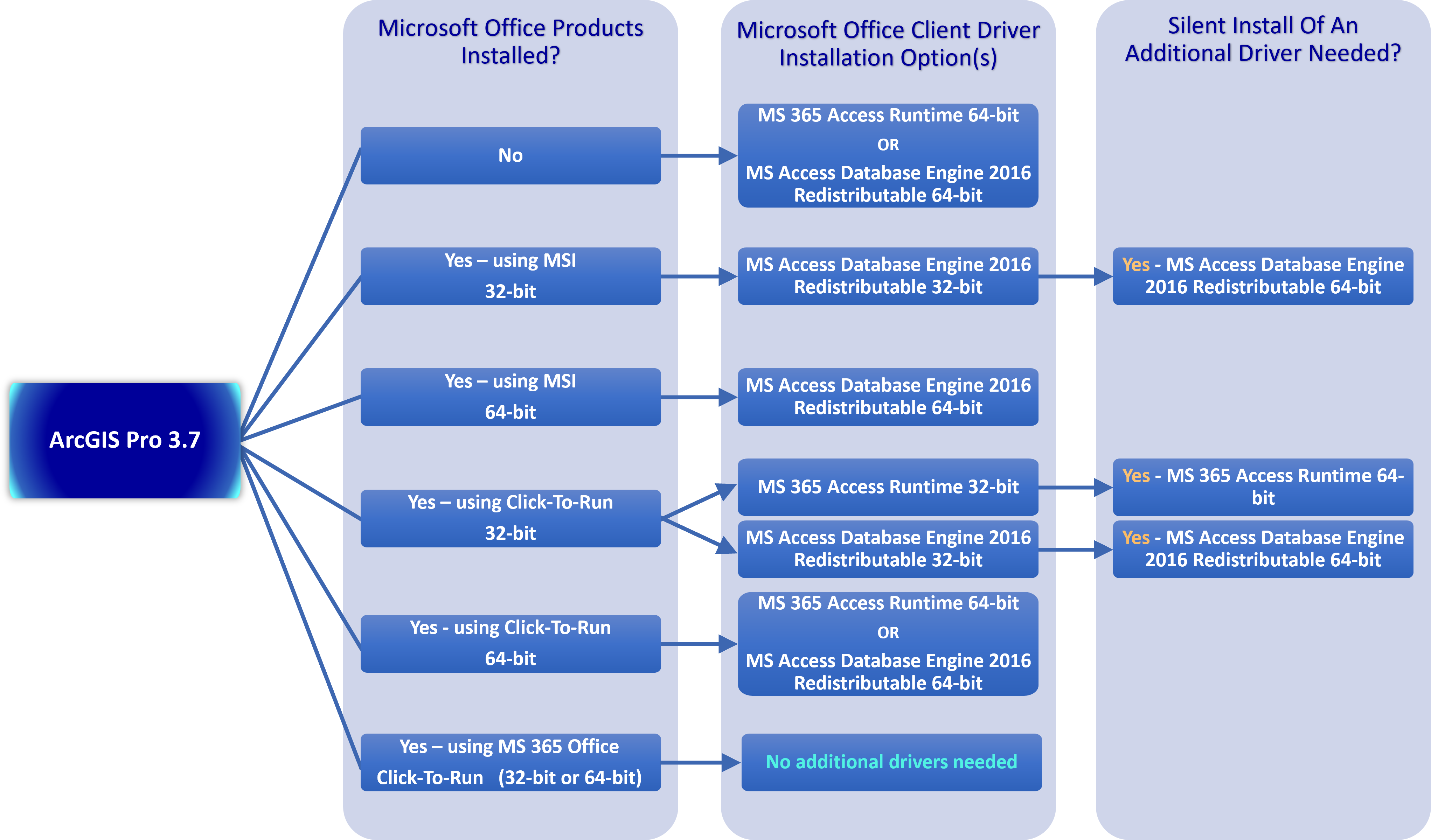

Driver installation decision tree
Based on your answers, use the following decision tree as a guide to help you determine if one or more Microsoft drivers need to be installed and if a silent installation of the additional driver specified is needed.
Microsoft driver installation decision tree guide to access Excel files from ArcGIS Pro
Some client machine and Microsoft Office configurations may not require any additional driver installations to access Excel files from ArcGIS Pro. Other configurations may require a silent installation of an additional specific driver before Excel files from ArcGIS Pro can be accessed.

  • Microsoft 365 Access Runtime (OfficeSetup.exe)—The Microsoft 365 Access Runtime files are available to download in either the 32-bit (x86) or 64-bit (x64) versions in all supported languages. Once you select the language, click the appropriate bit version to download.
    See Download and install Microsoft 365 Access Runtime on the Microsoft web site for the complete installation instructions
    Caution:
    Microsoft 365 Access Runtime is not compatible with Microsoft Office products installed with MSI. For more information, see Office installed with Click-to-Run and Windows Installer on same computer isn't supported. on the Microsoft web site.
  • Microsoft Access Database Engine 2016 Redistributable 64-bit driver—(AccessDatabaseEngine_X64.exe)—This driver is available to download in either the 32-bit (x86) or 64-bit (x64) versions, and you can access a list of supported operating systems specific to using this driver along with detailed installation instructions from the Microsoft Download Center.
Perform a silent mode installation
Microsoft policy only allows you to install drivers of the same bit version as that of the installed Microsoft Office products. If you try to install the downloaded AccessDatabaseEngine_X64.exe file on a machine that already has a Microsoft 32-bit application installed, you will receive an error message indicating that you can't install a 64-bit version of the database engine because you currently have 32-bit Microsoft Office products installed. A similar error message appears if you try installing the AccessDatabaseEngine.exe file on a machine with a Microsoft 64-bit application installed.
To work around this, complete the following steps to perform a silent mode installation of the downloaded files:
Caution:
Ensure that the ArcGIS Pro application is closed before performing a silent installation.
  1. Save the downloaded file to your computer on the C: drive.
  2. Using the Windows search box on the task bar, type Command Prompt.
  3. Right-click the Command Prompt application and click Run as administrator.
    The command prompt opens to a default directory.
  4. Type cd C:</mark> to change the directory to the drive where you saved the downloaded file.
  5. See the following examples to run the .exe file as a silent installation:
    • To perform a silent installation of the Microsoft Access Database Engine 2016 Redistributable driver, from the command prompt, type AccessDatabaseEngine_X64.exe /quiet or AccessDatabaseEngine.exe /quiet, depending on the file you selected to download from the Microsoft Download Center.
    • To perform a silent installation of the Microsoft 365 Access Runtime driver, from the command prompt, type OfficeSetup.exe /quiet. See Download and install Microsoft 365 Access Runtime on the Microsoft web site.
