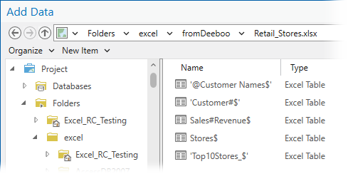

  • Available worksheets are shown in the Retail_Stores.xlsx workbook on the Add Data dialog box.
    Excel worksheets on the Add Data dialog box

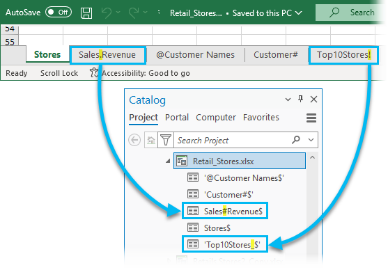

If the table name does not contain an expected character, it may have been replaced by the Microsoft driver before ArcGIS Pro accessed it. This is known to occur for a small subset of characters, including but not limited to, .! becomes #_ as shown in the following image.
A comparison of two worksheet names as they appear in Excel and in ArcGIS Pro.

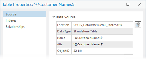

In the Catalog pane, you can access the Table Properties dialog box to review the properties for this stand-alone table.

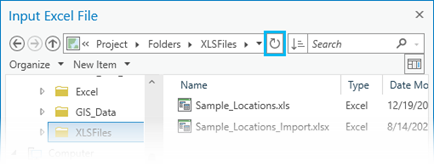

  • At the top of the Catalog view, your current location is shown in the location bar. Browse to the item connection or the specific item you want to refresh. Next to the location bar, click Refresh .
  • When using the Browse button to populate a geoprocessing tool's input, next to the location bar, click Refresh to get the latest information for the file used to populate the tool's input before running the tool.
    Refresh button is outlined
