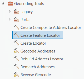

  2. Select the Create Feature Locator tool.
    1. In the Geoprocessing pane, click the Toolboxes tab.
    2. Click Geocoding Tools from the list of geoprocessing toolboxes.
    3. Click the Create Feature Locator tool from the list of geocoding tools.

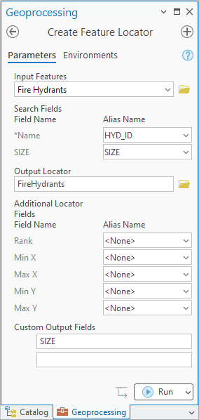

  5. Click the drop-down arrow in the Alias Name column and choose the proper field name to map the field in the data to the Name field under the Field Name column.
    Tip:
    For additional information and reminders about any of the input parameters on this tool, click the Information buttons next to the input parameters.
    An output file name and destination are automatically selected.
  6. To change the name and destination values, click the Browse button next to the Output Locator text box.
    The Output Locator dialog box appears.
  7. Specify where to store the locator (the save location must be in a file folder), name it, and click Save.
    Note:
    If you want fields in the data returned with results that aren't mapped to locator fields above, you can add those fields as Custom Output Fields values. Any field that you add here will be included in the geocoding results. The maximum number of custom output fields supported in the locator is 50. If the field in the reference data has no data, the custom output field will not be returned by the locator or listed in the Output fields tab of the Locator Properties dialog box.
  8. Click Run .
    Create Feature Locator tool pane
