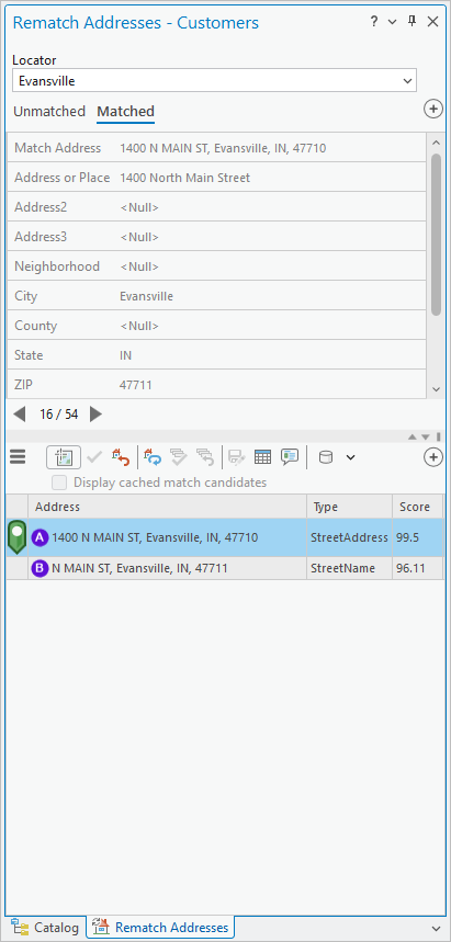

The Rematch Addresses pane is divided into several parts, which are explained in detail below. Relevant data and tools are grouped together.
Rematch Addresses pane example
You can resize the upper and lower portions of the pane by pointing to the line between the two parts of the pane. When the pointer changes to a resize pointer, you can click and drag to increase or decrease the size of the two parts proportionately. You can also click the arrow buttons on the right side of the line in the center of the pane to collapse the upper or lower portions of the pane. Once collapsed, you can click the arrow pointing in the opposite direction to expand that portion of the pane.
It is recommended that you keep both portions of the pane open simultaneously, since you need information from both portions of the pane to know which address you are rematching and the candidate to which you are geocoding the address.

Your geocoded feature class is divided into three categories in the Rematch Addresses pane: Unmatched, Matched, and Tied. You can click any of the three tabs to see the total number of results in each category. In the example above, 46 addresses are in the Matched category. Although not pictured, the same example has three results in the Unmatched category and one result in the Tied category. As you rematch addresses, the addresses move automatically into the Matched category, so when you finish the process, that should be the only visible category; therefore, the example above contains all 50 records at the end of the rematch process.
View geocoding results
The three categories displayed in the upper portion of the Rematch Addresses pane provide a way for you to view and change the address that is currently active in the pane; only the active address can be rematched or matched.
Clicking the arrows on either side of the numbers showing which record is currently active selects the previous or next address on the selected category tab (Unmatched, Matched, or Tied).
The active address displays a default set of fields drawn from the attribute table of your geocoded feature class. When you interactively match an address, some values automatically generate as geocoding output, such as the values for the Score, Side, Match_type, and Match_addr attributes. All the attributes from your original table of address data are also present in the geocoding results table. You can add or remove the fields from the table you want to view in the Rematch pane for each record by clicking the Select Fields button and checking the check boxes for the fields you want displayed.
The address candidates for the active address display in the lower portion of the pane. For each available candidate, a set of default fields always displays: Matched, Address, Type, and Score. You can add additional fields and hide any of these fields using the Select Fields button . The Menu button allows you several options. You can zoom to view all candidates displayed on the map by clicking Menu and clicking Zoom To All . You can re-sort the candidates based on their default sort order by clicking Menu and clicking Default Sort Order . You can also select a set of addresses from your geocoded feature class to focus on in the Rematch Addresses pane by using queries. Click Menu , and click Predefined Queries to view a list of options for available preset queries that you can use on your table or for the option to create a custom query. If you make a selection by choosing one of the predefined queries or creating one of your own, the Rematch Addresses pane refreshes and displays only those records selected by your query rather than all the records in your table. Those records still sort into the three available categories of Unmatched, Matched, and Tied.

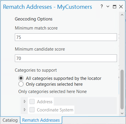

Modify geocoding options
Select Add or Modify Locator from the Locators drop-down menu to modify the geocoding options of any locator you want to use for rematching.
Geocoding options in Rematch Addresses pane
Only the geocoding options that are supported for a given locator are displayed. Modifying the geocoding settings does not change the original settings in the locator. As a result, any geocoding settings that you modify are not saved if you save your project and exit the application, and you will be required to modify geocoding options again if you do so.
