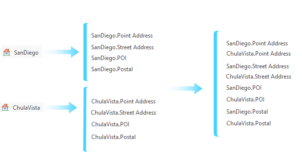

  • Order by role and score—Individual roles of participating locators will be grouped and ordered from most to least precise. Results will be returned for more precise roles first followed by less precise roles, and where results are returned for different locators with the same role, results will be returned based on score. It is recommended that you use this option if you have a multirole locator and several single role locators or if you have more than one multirole locator. This automatically orders your locators and roles into a recommended, optimal fallback order.
    Participating multirole locators grouped by roll and fallback order by score

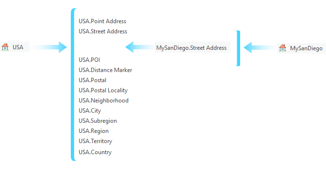

  • Custom order—A customizable fallback order for participating locators allows you to insert locators between the roles of a multirole locator. Locators cannot be inserted between multirole geocode services.
    Customized fallback order of participating locators in a composite locator
