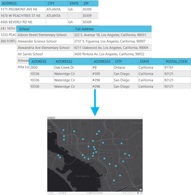

Convert a table to locations on the map
Address table formats and results on the map

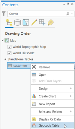

  2. Open the Geocode Table pane, and begin the guided workflow.
    1. Right-click the table in the Contents pane of the map, and choose Geocode Table.
      Geocode Table option
      The Geocode Table pane appears. It displays a list of steps to use to geocode the table.

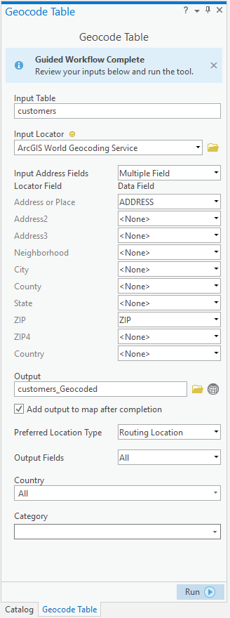

  9. Review all inputs in the final step of the guided workflow, and run Geocode Table.
    1. Confirm that all the inputs on the final page of the guided workflow display the inputs you chose in the previous steps.
    2. Click Run.
      The progress of the tool is displayed at the bottom of the pane.
