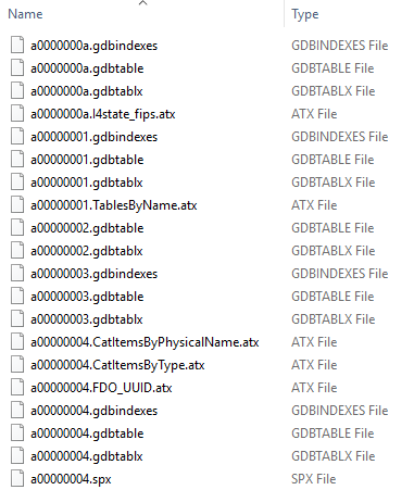

File geodatabase files in File Explorer
A file geodatabase is stored as a folder of files. When you view the folder with File Explorer, apart from the .gdb extension, it looks like any other folder, and you can view its contents. The folder contains cryptically named files that hold geographic data, attribute data, index files, lock files, and a signature file, as well as other files. Each feature class or table in the geodatabase is stored in two or more files. It is difficult, if not impossible, to tell which files make up any given dataset.
List of files in File Explorer
