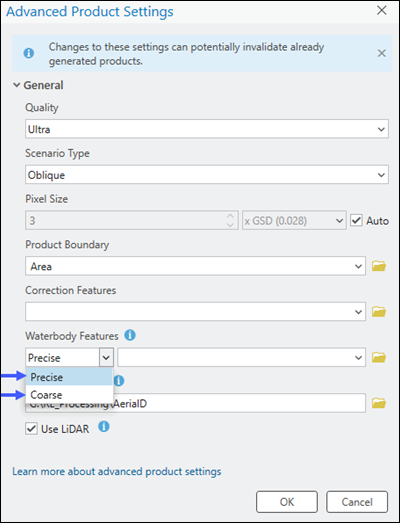

  2. Click Shared Advanced Settings.
    The Advanced Products Settings dialog box appears, where you can define parameters that will determine all Reality mapping products to be generated. For a detailed description of the advanced product settings options, click the Learn more about advanced product settings link at the bottom of the dialog box.
    Advanced Product Settings dialog box for generating a 3D mesh
    The Quality and Scenario Type settings are automatically set by the application and should not be changed to ensure optimum performance and product quality. However, if you want to generate a reduced resolution product, you can lower the Quality setting. See Shared Advanced Settings above for more information about the impact of the various Quality options on product generation.

  4. To specify a water body feature layer, click the Browse button next to Waterbody Features.
    Note:
    If water body features, such as lakes and rivers, exist within the project area, it is recommended that you add a precreated 3D feature class identifying those areas, using the Waterbody Features setting to hydrologically enforce those features in the output product. Use the stereoscopic compilation in ArcGIS Image Analyst to generate the 3D feature layer that identifies water body features. This ensures that there will be no image stretching around hydrological feature boundaries in the output due to differences in elevation between the derived digital surface model (DSM) height and the feature class height values.
    There are two Waterbody Features options: Precise and Coarse. Use the Precise option when the 3D polygon being added accurately defines the shape of the hydrological features in the project area. Precise polygons can be created using the stereoscopic compilation in ArcGIS Image Analyst. A precise water body polygon can also be derived from national mapping organizations with open data policies. Additionally, it can be created using 2D heads-up digitizing from an authoritative, orthorectified imagery that is temporally similar, with the aid of a DEM.
    Use the Coarse option when a generalized 3D polygon is being used as the water body feature. Generalized polygons can be created using a 2D heads-up digitizing workflow. If 2D heads-up digitizing is used to create a precise or coarse polygon, it must be converted to 3D (x,y,z) before it can be used as a water body feature. See Introduction to 2D and 3D features for additional information about converting a 2D feature to 3D. When using a coarse water body feature, the shape of the polygon must follow the shape of the water body feature for best results.

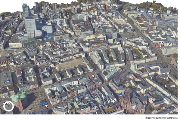

  11. To visualize the generated 3D mesh, right-click the 3D_Mesh.slpk file in the Mesh folder, and from the drop-down menu, click Add to New > Local Scene.
    3D mesh with building facades
